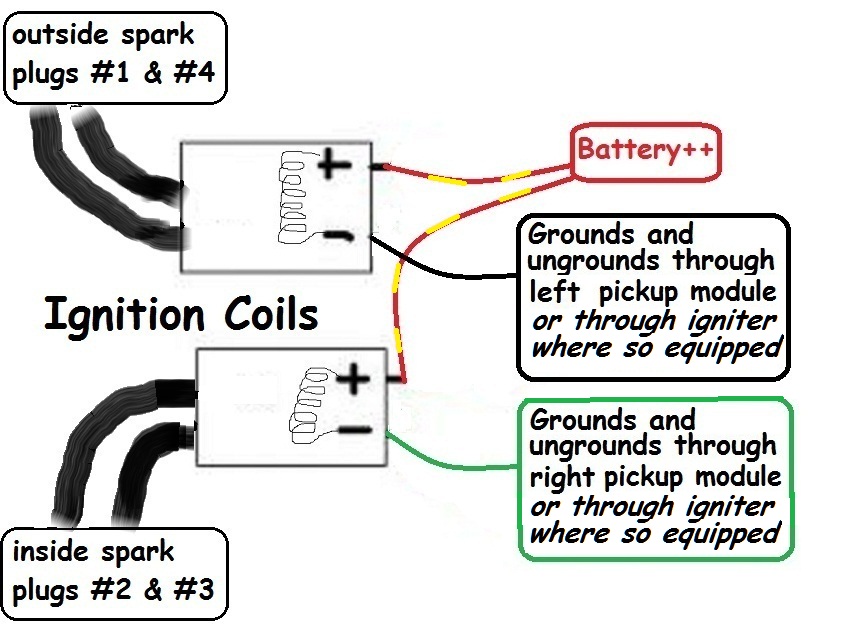

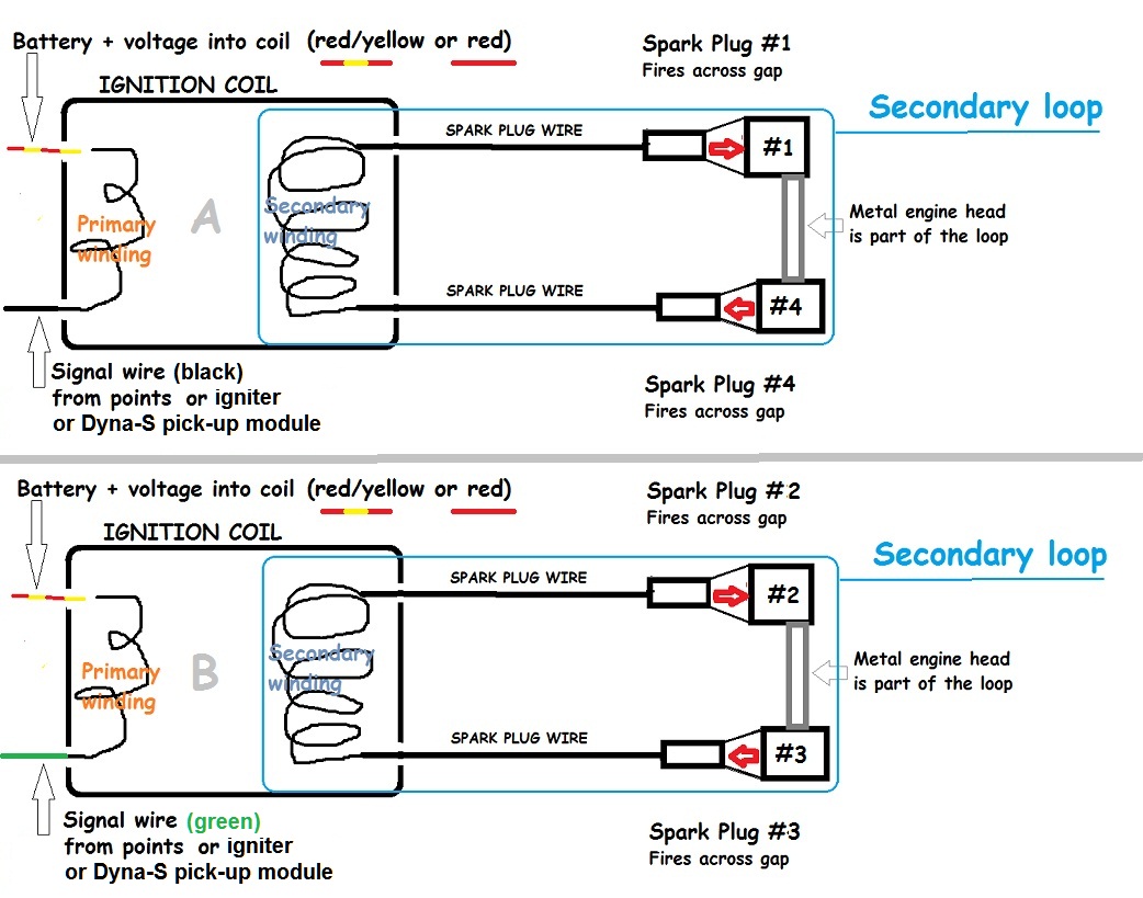

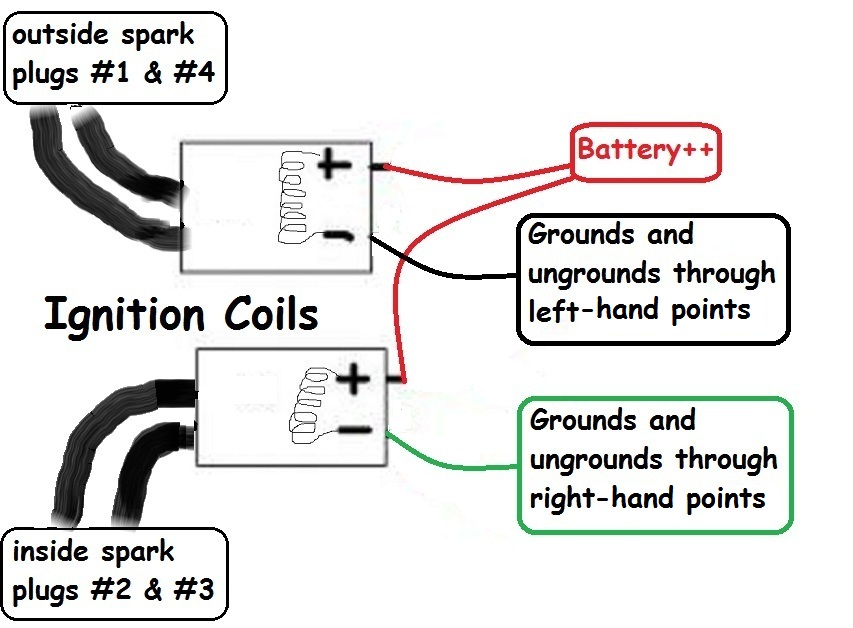

Where an ignition coil is receiving adequate voltage, lack of spark might possibly result from a failure to become ungrounded when the points open.
Spark failure could also result from various causes related to the secondary loop.
EDIT -- The following diagram is added to clarify that the Kawasaki electronic ignition uses modules (under the points cover) together with an igniter to ground and unground the ignition coil (in the same fashion as closed and opening points grounds and ungrounds the ignition coil). Same for Dyna-S ignition without an igniter. The critical function remains the same with points or non-points ignition, being to provide ground for the ignition coil primary winding (during which time the coil charges), and then to unground the ignition coil primary winding, which ungrounding causes the coil to fire through the secondary loop.
