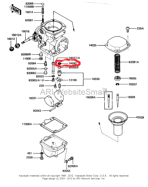

Have you checked the screens above the float needle and seat? #14043 in the fiche.
