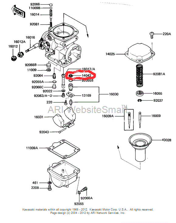

Ok, I got some plug wires from my local kawasaki mechanic and kz guru. Put them on and same problem. I now have very strong spark, but after riding 10 minutes give or take, I drop 1&4. Barely make it home. Occasionally it surges violently and other times less violently, but overall, it runs horrible after that first 10 min of good running. The petcock seems to be flowing very well, but the service fuel level is extremely low on outside carbs.... I put a new fuel filter on and same results...

I did a hot and cold compression check, so that pretty much rules out any valve issues. I took the carbs off and the fuel cross over tubes were full of gunk. Cleaned out my tank again, I'll let y'all know if it does any good.
