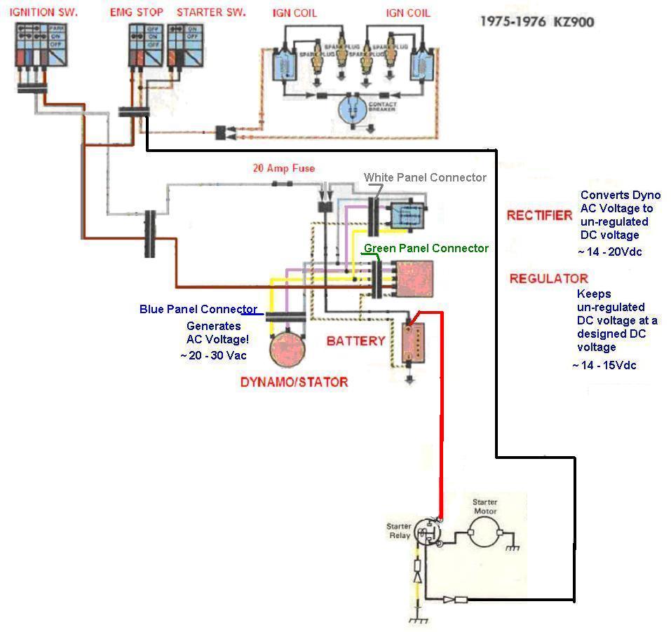

I went out and took a look at my bike. Looks like I will just unplug and remove the original rectifier and regulator. Mount the new RR combo (on plate) in place of the old regulator, plug it into the original regulator connector (green), ground it, and plug into the red/white bullet connector to feed the juice back into the battery.
Sound correct? Do you know of a good way to cap off the connector (white) where the original rectifier was plugged into?
I need to do this because after reading this thread I checked my voltage and I am getting almost 20v at around 4-5K rpm. I will check/clean the regulator connections and ground first but I bet its toast.
