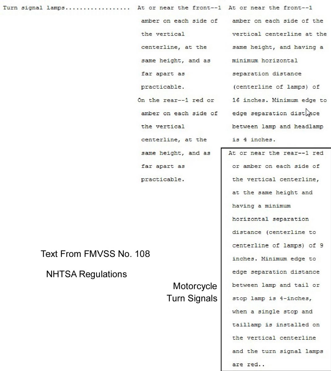

12 Jul 2012 22:12 - 12 Jul 2012 22:14Not me because they are illegal according to the Fed's requirement for motorcycle tail lights, ie specification from NHTSA. Note rear turn signals must be a minimum of 9 inches apart. See attached:esion wrote: I have been doing quite a bit of searching on cafe part sites for tail lights but I haven't found the perfect one yet.
Does anyone have experience with a tail light with integrated signals?

I grabbed one of those tail-tidy things, it's basically a couple of slotted strips of metal with tiny ears for signals. Used a couple of mini signals that are vaguely arrow shaped. I'm not sure if any of the lights are DOT approved, but they're bright as hell and I figure if some old granny can't see over her steering wheel enough to notice two arrows pointing the direction I'm going, then I'm doomed anyway.

Cool lookin bike, agreed on the 9 inch thing, I have paid that fine! Also, what bike was that light marketed for? I liked the way it fit, just not a fan of clear
