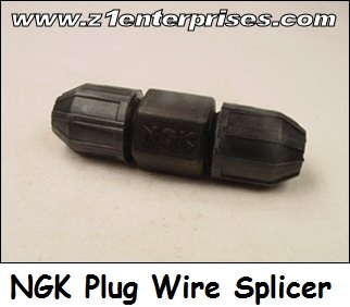

Look carefully at the ignition coil, does it have ridges on the caps where the sparkplug wires go? If so, the caps will unscrew making removal of the plug wires easy. To make installation easier, use rubbing Alcohol as a lubricant for the rubber pieces inside the caps.
7mm sparkplug wires will go right in the coils. If the sparkplug wires are molded into the coils(some are), the only way to replace the plug wire will be to go to www.z1enterprises.com and buy 4 of the NGK sparkplug wire "Splices".

NGK Plug Wire Splicer
TU38-1024
Used for splicing new wires on old coils. Joins two sections of plug wire together.
$5.57
Click here > www.z1enterprises.com/detail.aspx?ID=1890

mtkawboy wrote: ...Where the wire goes into the coils it has boots on it....
Am pretty sure the stock coils have the plug wires permanently attached.
The rubber boot is likely just a protective cover.
If fitting the splicers, be sure to leave ample stub lengths from the coil to accommodate both the splicer and the boot.

I have seen kits with the wires and splicers I think they are like $40 - $50. If those are original coils I would not spend money on them, I would punt them into the can.

I agree with bounty hunter. I went the new wire and splicer route and spent prob. $50+ dollars and am having problems with them. That suppression core wire sucks IMHO.
