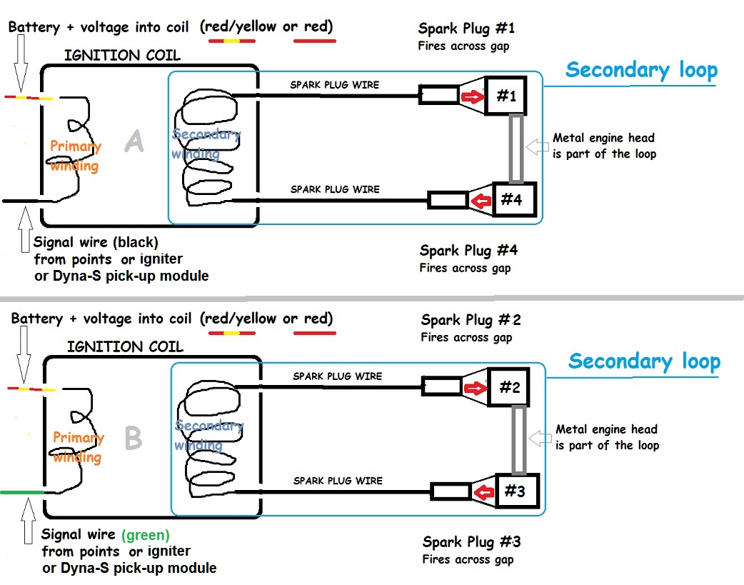

15 May 2012 16:05YES. The plugs are in series, so one fouled or open plug will kill the spark from both.Arnold wrote: Thanx !
But are you sure...cause I dont have a spark on two plugs (1-4) ?
Could one bad plug effect both lines from that coil ?
/Arn

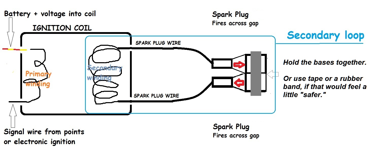

High intensity voltage travels through the secondary loop.
When conductivity through the secondary loop is truly prevented, neither spark plug can fire because there's no voltage running through the plug.
When removing a plug cap makes no difference, and the other plug in the loop is firing, voltage is somehow else being completed through the secondary loop, perhaps via shorting from the plug wire through the engine head.
When removing a plug cap makes a difference, both plugs are then not firing, whereas only one of them was firing before the cap was removed.

16 May 2012 15:10 - 16 May 2012 15:11I don't think the coil outputs can be in parallel, they have to be in series like the drawing shows above. If they were in parallel, only one would fire which dumps all the energy in the coil at whichever plug arced first.TomW wrote:bountyhunter wrote:YES. The plugs are in series, so one fouled or open plug will kill the spark from both.Arnold wrote: Thanx !
/Arn
Not on the Dyna green coils. When I had a #4 plug foul out I pulled the wire off #4 while riding and there was no change, the engine missed on only 1 cylinder. When I pulled the wire on #1 the missing got worse, now running on only 2 cylinders. My conclusion, coil secondaries are in parallel. Don't try this in the rain. :ohmy: :woohoo:
As shown above: if a plug wire shorts to ground (either externally or inside the coil) you can have one plug sparking.

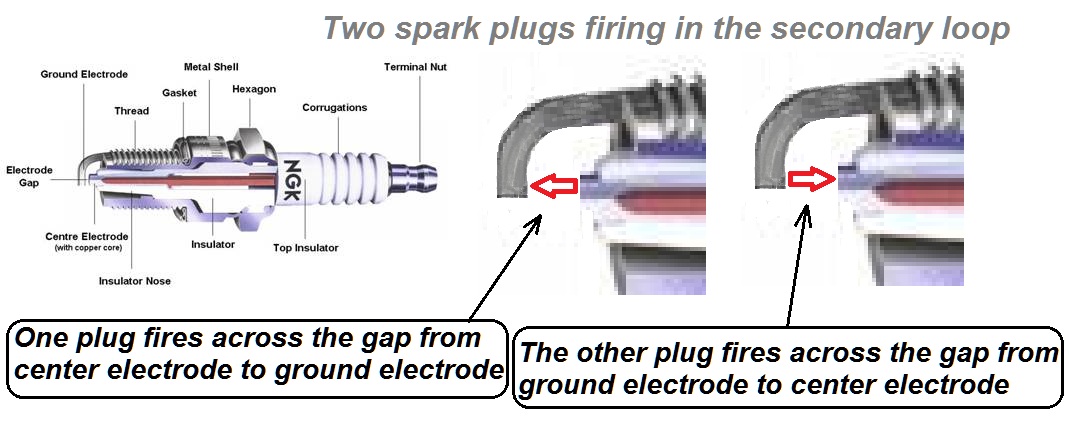

Although it might seem counter-intuitive, firing through the secondary loop travels across the plug gaps from center to ground in plug A and from ground to center in Plug B.
Try this test to visually observe which way the spark jumps.
Gonna have to look really fast! :woohoo: :lol:

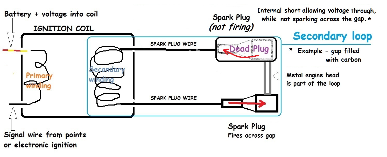

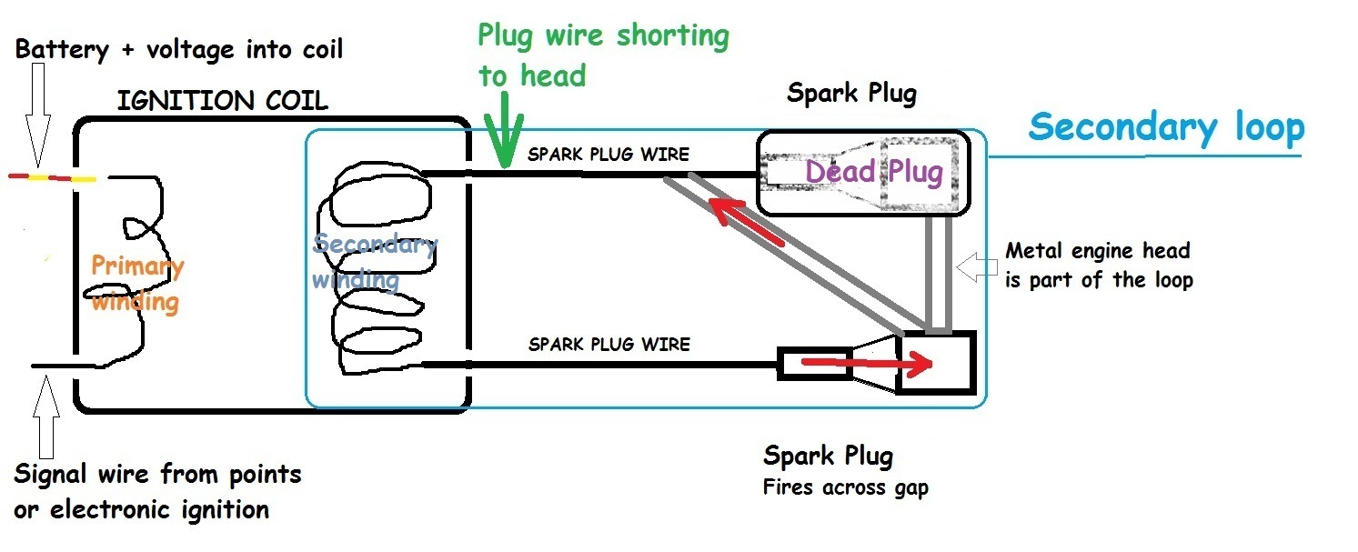

The FSM is misleading when saying that one non-sparking plug results in both plugs not sparking.
One plug in the secondary loop may indeed fire alone, provided the secondary loop isn't broken.
For instance a non-firing plug may have a carbon-filled gap allowing voltage to pass through.
Or a plug wire may be shorting to the engine head in a manner whereby the secondary loop is completed.
