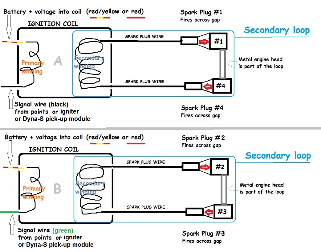

Would also ohm-check coil's (1) primary winding, and (2) secondary winding, measuring resistance between clips inside the plug caps.
If there's a break in conductivity somewhere within the secondary loop, it typically results in loss of spark at both plugs.
Sometimes it helps to remove the cap and snip the plug wire ΒΌ" to gain a better connection with the cap.
And sometimes a cap is found defective.

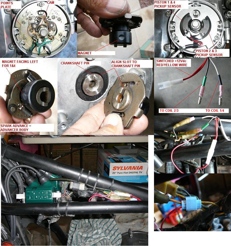

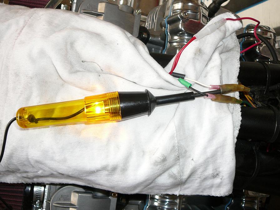

Did you perform the Dyna Static Alignment/Tests (12Vdc lamp tester)...?
Dyna rotor Magnet on the correct orientation (TDC 1/4, should be pointed left)...?
Here's some issues/things I encountered, possibly help you out...
DYNS S Installation
NOTE: Solder the +12Vdc versus crimp as in the bottom right image...
1976 KZ900-A4
MTC 1075cc.
Head: P&P via Larry Cavanaugh
ZX636 suspension
MIKUNI, RS-34'S...
Kerker 4-1, 1.5" comp baffle.
Dyna-S E.I.
Earls 10 row Oil Cooler
Phoenix, Az
