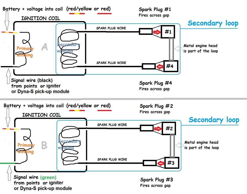

Would also ohm-check coil's (1) primary winding, and (2) secondary winding, measuring resistance between clips inside the plug caps.
If there's a break in conductivity somewhere within the secondary loop, it typically results in loss of spark at both plugs.
Sometimes it helps to remove the cap and snip the plug wire ΒΌ" to gain a better connection with the cap.
And sometimes a cap is found defective.

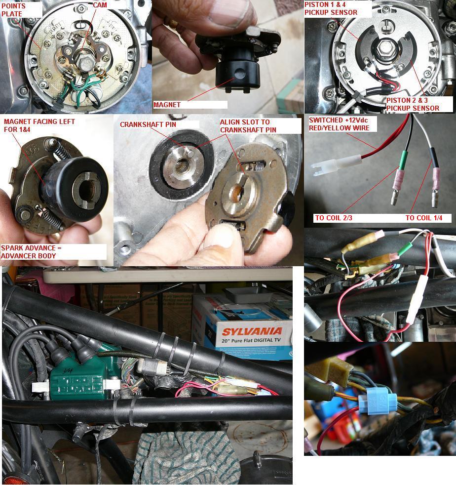

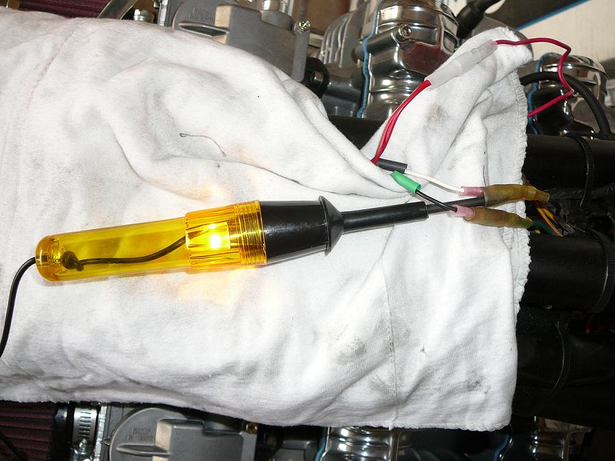

Did you perform the Dyna Static Alignment/Tests (12Vdc lamp tester)...?
Dyna rotor Magnet on the correct orientation (TDC 1/4, should be pointed left)...?
Here's some issues/things I encountered, possibly help you out...
DYNS S Installation
NOTE: Solder the +12Vdc versus crimp as in the bottom right image...
DYNS S Installation
