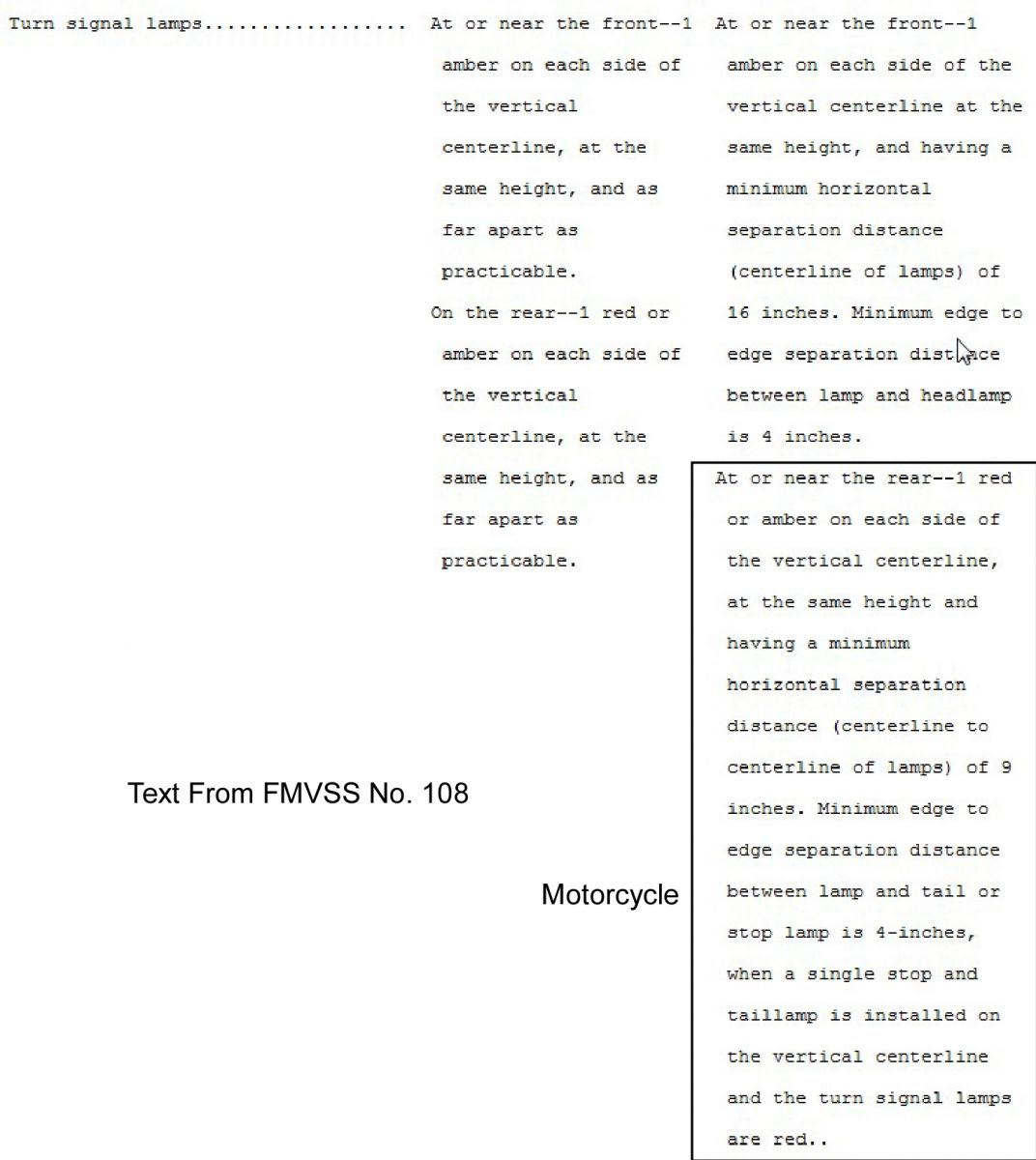

You need load resistors to use the stock flasher with LEDs, but solid state flashers are available at all car parts stores.
FYI: that rear light is illegal for street use. Read the attached text and note the part about a minimum required spacing of 9" between the centers of the turn signal bulbs.
The ad says it fits a CBR600, it never says it is street legal or DOT approved.
