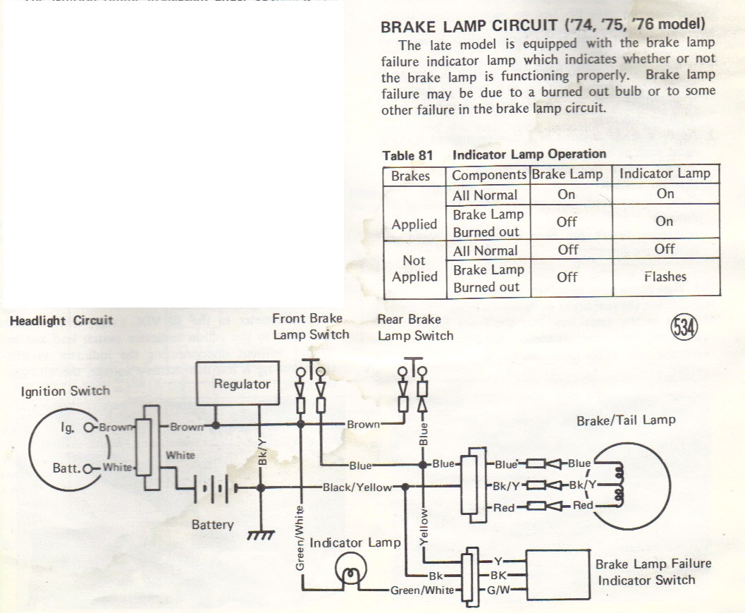

02 May 2012 06:18 - 02 May 2012 06:31Patton wrote:bountyhunter wrote:My 79 KZ750 has one: it's the flasher that tells you when the brake light is blown.Jonny wrote: I know most of out bikes don't have a 'light out' warning anywhere, so that shouldn't be an issue.
Jon
As known, the brake-light-warning idiot light is supposed to remain dark while cruising along without any application of either brake.
During brake application, the idiot light is supposed to burn a steady bright red.
(This lets the world know that the idiot light bulb and its related circuitry are functional).
Here's the "warning" part:
When the rider notices the idiot light is "blinking" when supposed to be dark while cruising along without either brake applied, the "blinking" idiot light is warning the rider that "the next time brake is applied, the rear brake light ain't gonna light up."
Such warning typically results from a blown brake light filament in the rear bulb, but may also result from other deficiencies such as a bad wire, loose connector, etc.
Zedone wrote: ...are you saying the red panel brake light indicator (idiot light) shd light up when your brakes are normally applied, and then shut off after the brakes are released? Its been +15 years since I had my bike on the road (I can't remember). Is this for the Z1 & KZ up to 1980?....
Here's an excerpt from the FSM covering Z1~KZ900.
Am thinking -- but not positive -- that the same feature is shared on most Kawasaki motorcycle models through the 1979 models, at least on the large fours.
Where applicable, the wiring diagram for a particular year and model will show "Brake Light Failure Indicator Light" as one of the information bulbs visible to the rider.
