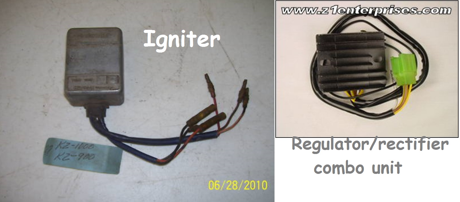

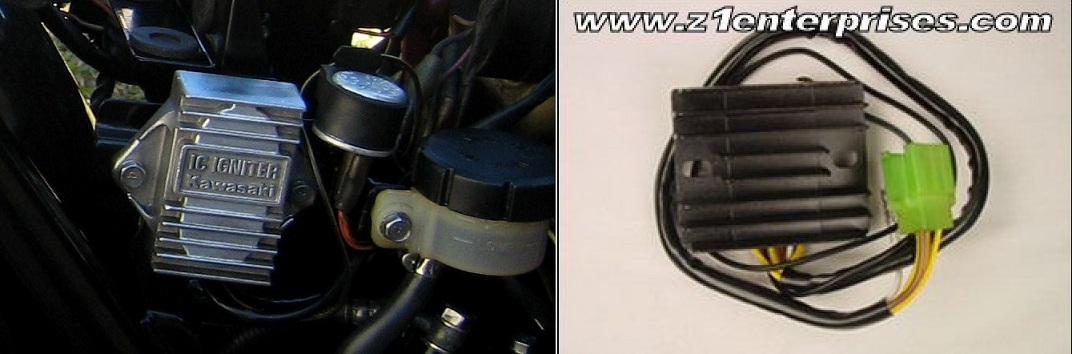

Am thinking these components are designed for at least some minimal air flow for cooling purposes.
And the oem mounting locations allow for at least some minimal air flow.
Although some igniters are unfinned, others are finned, as are the regulator/rectifier combo units.
Would suggest not completely blocking them from any air flow.

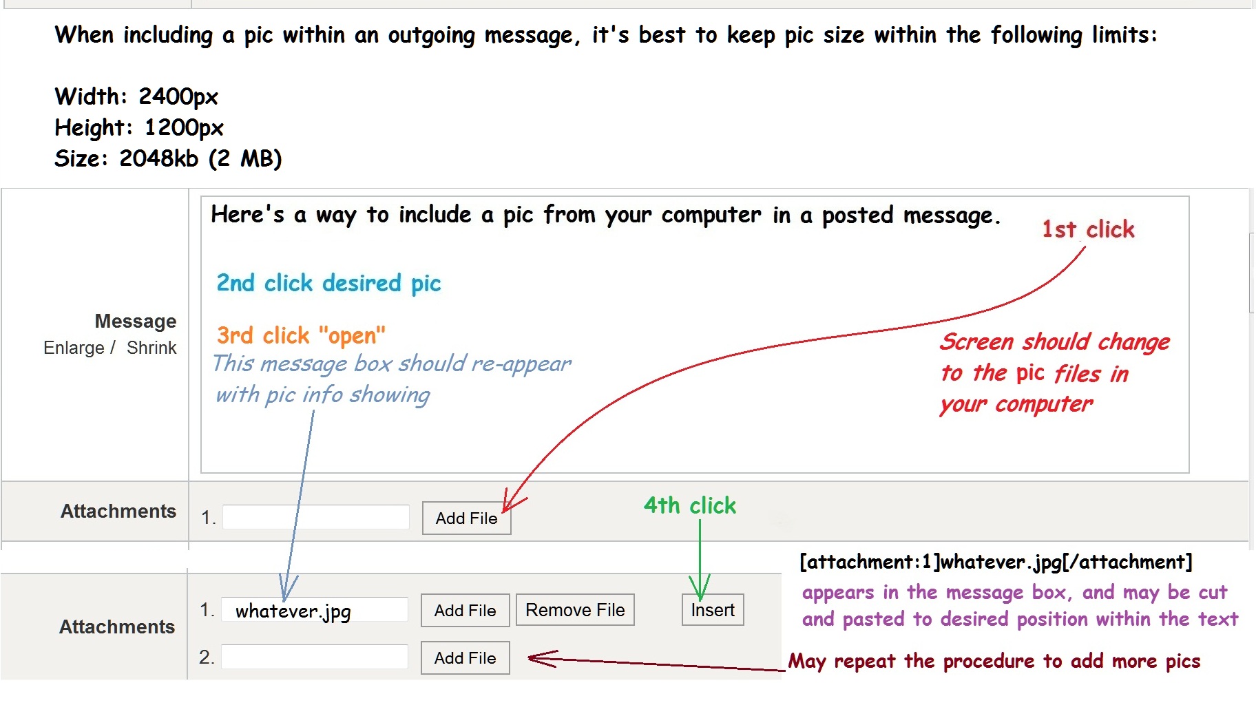

If needed, here's some help about uploading pics.
