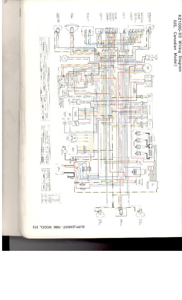

08 Mar 2012 17:33 - 08 Mar 2012 17:36 #508583
by 531blackbanshee
Replied by 531blackbanshee on topic 1980 z1r starter button smokes ignitor ground.
thanks for the input lou.
i will take some photos and post up.
there is a 1980 d3 (z1r) wiring diagram in the file base.
it is a pdf or i would post the pic here.
Last edit: 08 Mar 2012 17:36 by 531blackbanshee.

08 Mar 2012 18:59 - 08 Mar 2012 19:08 #508606
by 531blackbanshee
Last edit: 08 Mar 2012 19:08 by 531blackbanshee.

09 Mar 2012 00:05 #508669
by BlackZ1R
Kawasaki
Someone once told me to marry that motorcycle I was riding ......there's times I wish I hadda listened .
Replied by BlackZ1R on topic 1980 z1r starter button smokes ignitor ground.
Leon, that diagram looks completely different to the one in my manual for the 1980 Z1-R. After we talked today, I didn't realize it was the ground to the ignitor that fizzled on you until I read this thread.
I'm with the others that stated it is a ground issue. The ignitor ground plugs directly into the the bl/y right off the battery, like you stated. From there to the starter relay and lighting circuits.
Check all the grounds and the starter relay for any loose connections.
It's been so long since I looked at my Z1-R wiring, that I can't remember where the blk/y connects to the frame. It should be near the coils, unless I'm badly mistaken.
A bad/loose frame ground is going to send battery current into the secondary ground wires like how you described when there is a high current draw from the starter motor.
Like loud said, there's no fuses on the ground side of the harness.
A fused ignitor ground might be something to look at.
