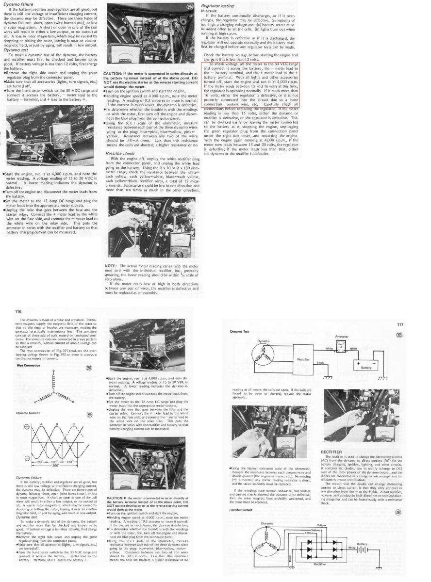

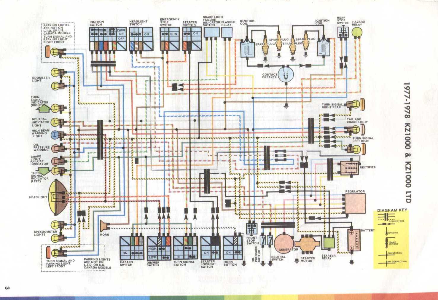

Unfortunately there's no easy answer in electrical issues... Either open or shorted conductors/components in the wiring. Start with the bare bone basics and go from there...
Based on your info, most likely ignition switch but open wiring/disconnected/corroded/burned up terminations (connectors) are possible as well especially considering fuse had been bypassed.
With volt meter, frame ground properly or black meter probe to battery (-).
Measure for Battery voltage ~ (12Vdc) on good charge.
Measure voltage input to ignition switch, 12Vdc?
Key turned on, ~12Vdc on out put of ignition switch?
Then follow to headlight switch -> headlight bulbs...
Do the same for other components such as horn,
In case you need... Z1, KZ900 and 77-80 KZ1000 95% the same...
Z1 service manual.... Z1/900 OEM Kawi Service Manual
1977/78 KZ1000 Wiring Diagram...
Electrical Testing...

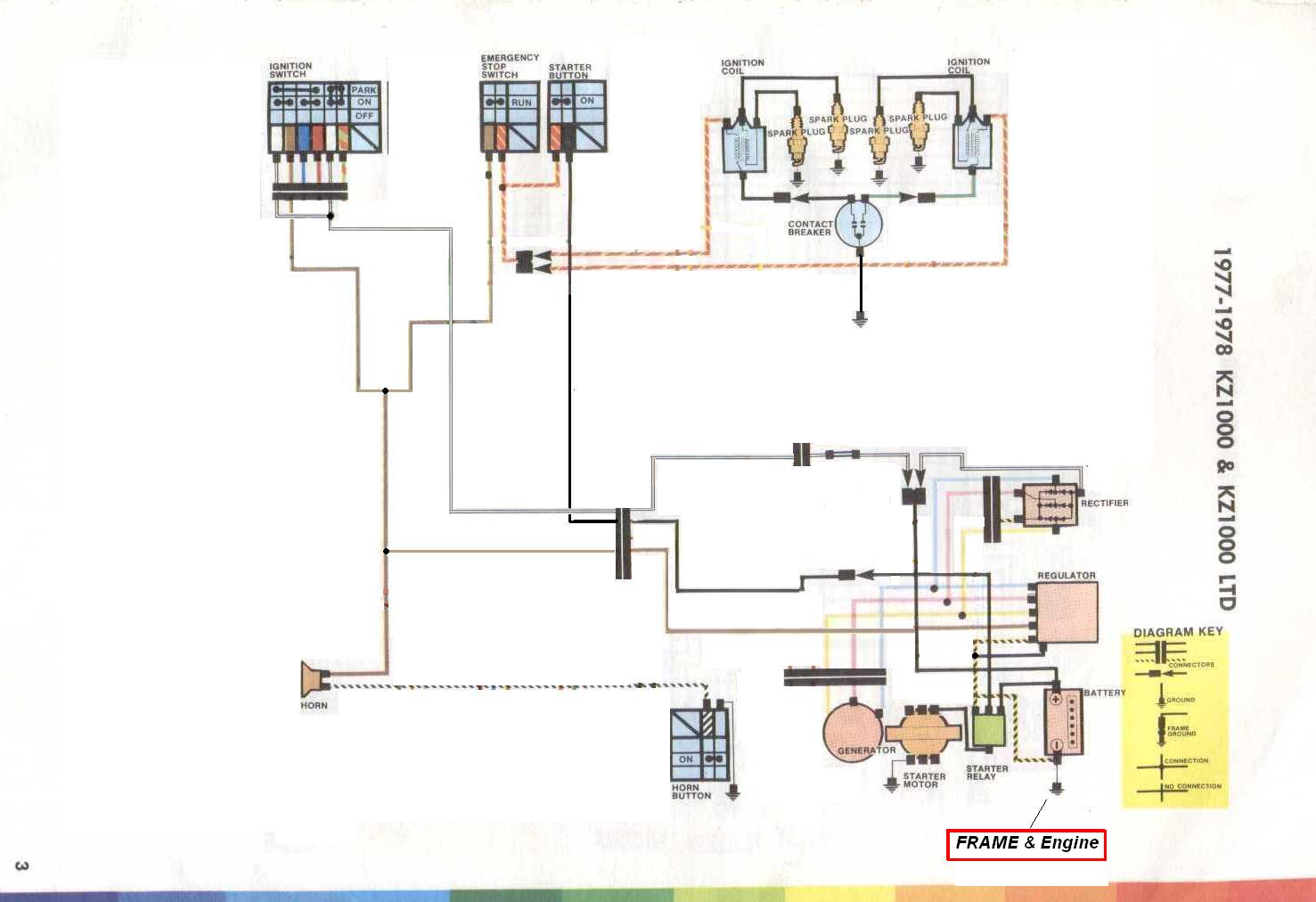

Maybe this will help, bare bones with exception of leaving the horn in to test ignition switch....
Okay, emergency stop switch isn't required as well and can be bypassed....
