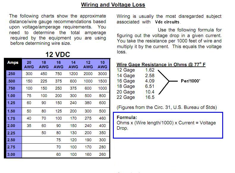

22 Jan 2012 17:11 #499427 by MFolks
Replied by MFolks on topic Wire Choice? (For rewiring)
