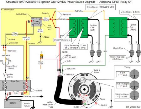

i need some help. im wiring my bike. a simple chopper wire job. coming off my dayna ignition switch is 2 red wires, 1 black wire, 1 white wire and a random blue wire? and then coming off my (brand new) coils are 1 black and one yellow wire. can someone help me get going from this point. Im running a headlight, tail light. a on/off switch and a push button start. Thank you very much and um Merry Christmas!

Would help if we new exactly what model KZ and Dyna-S you're using...
Based on conductor colors assuming DynaS-2 series I.E...
NOTE: Confirm with your Dyna wiring diagram the conductor coloring.... Or post the diagram provided and we should be able to help you out...
On the KZ650 for example, I.E. Plate is grounded through frame...
Blue is the oil pressure switch.
Red is +12Vdc (Battery red/yellow conductor switched (after ignition switch))... Best to solder versus using butt splice provided.
Black in other Dyna-S wiring diagrams go to cylinder 1/4 coil.
White goes to 2/3 coil...

also i have the coil on the left hooked to the 1&4 plug and coil on the right to the 2&3 plug? looks like my manual as left coil to 1&2 plug and right coil to the 2&3?
- Posts: 18568
- Thanks: 2101
Re: dayna ignition
25 Dec 2011 17:12 - 25 Dec 2011 17:14SCHWACKS wrote: also i have the coil on the left hooked to the 1&4 plug and coil on the right to the 2&3 plug? looks like my manual as left coil to 1&2 plug and right coil to the 2&3?
Bike has two ignition coils, one of which fires 1&4 spark plugs, and the other fires 2&3 spark plugs.
Large Kaw fours typically mount the coil firing 1&4 spark plugs on left side of frame (shift lever side); and the other coil firing 2&3 spark plugs on right side of frame (foot brake pedal side).
Smaller Kaw fours typically use the reverse coil mounting positions.
But the mounting position really doesn't matter, as neither is superior to the missionary position.
What's really important is that the signal wire from the left side (a/k/a rear or 9 o'clock) pickup module attaches to whichever ignition coil is firing the two outside spark plugs #1&4.
And that the signal wire from the right side (a/k/a forward or 3 o'clock) pickup module attaches to whichever ignition coil is firing the two inside spark plugs #2&3.

Sorry another question. So the two red wires of the ignition go to the yellow wires off the coils?
- Posts: 18568
- Thanks: 2101
Re: dayna ignition
26 Dec 2011 13:14 - 26 Dec 2011 13:17SCHWACKS wrote: Sorry another question. So the two red wires of the ignition go to the yellow wires off the coils?
Very possibly.
The ignition pictured looks different than a Dyna-S. Perhaps it's an earlier model Dyna or some other brand.
Anyhow, am reasonably sure that in order to function, the pick-up modules need battery positive voltage, usually supplied when the keyed ignition switch is in the ON position, commonly referred to as "switched battery positive."
Dyna-S has a red power wire and a black signal wire and a green signal wire ( plus a blue oil pressure sender wire on KZ650).
The red power wire is spliced or plugged in somewhere into the bike's harness to provide switched battery positive to its modules.
The wire (typically green) from the 3 o'clock module is a signal wire that attaches to whichever coil fires inside spark plugs #2/3.
The wire (typically black) from the 9 o'clock module is a signal wire that attaches to whichever coil fires outside spark plugs #1/4.
The ignition at hand may have a separate red switched battery power wire to each pick-up module.
A common source used to spice into for providing switched battery positive to the pick-up modules is the bike's harness wire (ofter red or red/yellow) that's furnishing switched battery power to the ignition coils.

So heres the dayna s i have. One red, one white coming from the 9'oclock module. and one red, one black wire coiming from the 3'oclock module? and a single blue wire coming from behind. no green?
- Posts: 18568
- Thanks: 2101
Re: dayna ignition
26 Dec 2011 18:35 - 26 Dec 2011 18:37With the color scheme at hand:SCHWACKS wrote: So heres the dayna s i have. One red, one white coming from the 9'oclock module. and one red, one black wire coiming from the 3'oclock module? and a single blue wire coming from behind. no green?
Red wire splices or plugs into any bike harness wire that supplies switched battery positive. Whereby switched battery positive is furnished from the bike harness wire to the Dyna-S modules;
White wire from the 9 o'clock Dyna-S module attaches to a primary terminal on whichever ignition coil is firing the two outside spark plugs #1&4;
Black wire from the 3 o'clock Dyna-S module attaches to a primary terminal on whichever ignition coil is firing the two inside spark plugs #2&3;
Blue wire attaches to the oil pressure sending unit.
There are only the four wires (red, white, black and blue), so forget about a "missing" green wire.
Dyna-S sometimes puts a green "collar" on a black wire from the 3 o'clock pick-up module, and calls it the "green" wire. And perhaps put a black collar on a white wire from the 9 o'clock module, and calls it the "black" wire. Go figure. :huh:
Be careful to install the Dyna-S rotor correctly, and not 180 degrees out.
The small pencil-eraser-size magnet embedded in the rotor should be facing toward the 9 o'clock module as the 1/4 F mark aligns with the permanent timing mark on the engine case as seen through the timing inspection window.
