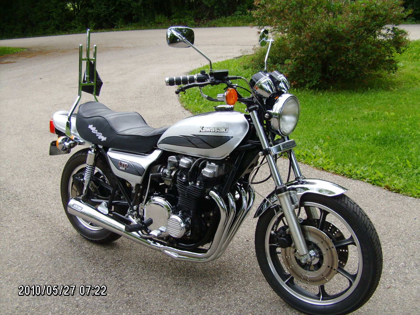

07 Nov 2011 18:29 - 07 Nov 2011 18:30I was thinking of switching over to LED bulbs in my running/turn signal lights & brake/plate light, because I'm going to have to get a brighter halogen headlight {as I cant see as well at night, now that I"m in my 50's}. and I know it will draw alot more juice, P,S,I also have a DYNA 2000 that draws alot of juice......so after checking a few web sights, they say that they will not be as bright as incandesant bulbs if used with the stock corregated lenses. 7 if I did switch over to the LED's, would i have to change my flasher as well ?? I know another option would be to switch over to a n HID xenon headlight. (waiting to hear back from Otocar) as he seems to have a lot of experience with that convertion...OH yea the bike I"m doig this to, is a 1980 LTD 1000.
