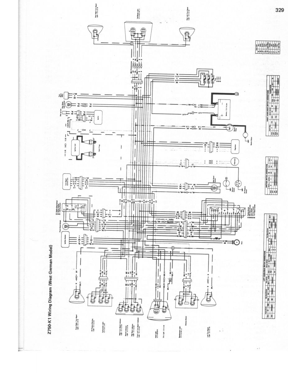

Here I found this wiring diagram, if you zoom in it is readable. If you open in Paint or another editor, you could circle or highlight your questionable connectors.

Red/white with a Bullet, thats the wire that runs from the Regulator/ Rectifier back to the battery. That should be the Charging system Output wire. It should be connected back to the battery + terminal, there will be a double connector that this Red/white will plug into. the other side of that double will have a white wire going to your fuse panel. This will feed the Main Fuse.
