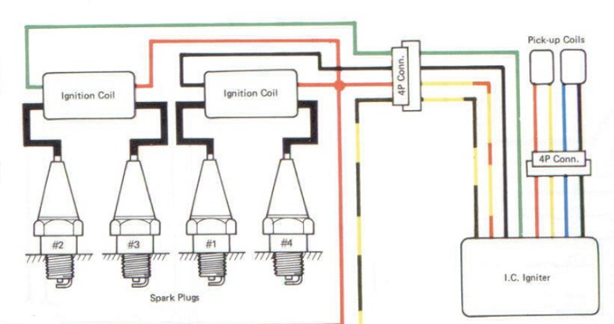

I suddenly dont have the same power in engine as before. I touched the header pipes with my fingers with spit on them and only cylinders 2 & 3 were hot, cylinders 1 & 4 were warm. Pulled the spark plug wire out of cylinder four, and she ran the same. Put a new set of plugs and still the same problem. How can I tell if ignition coil needs to be replaced or the spark plug wire need to be replaced? I have a meter. Thanks for any help I can get. Mopguy in Toronto.

One quick way is to swap the coils temporarily. If the problem moves to the other 2 cylinders it's the coils, wires, or caps. Ed

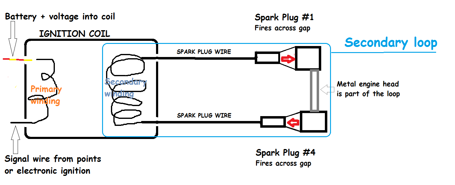

Would assure the coil for 1/4 is receiving full battery voltage via red wire to its primary winding.
Good Fortune! :)
  • Patton
  • Patton's Avatar
  • KZr Legend
  • KZr Legend
  • Posts: 18568
  • Thanks: 2102
Re: 1980 KZ750
25 Sep 2011 11:36 - 25 Sep 2011 11:38
#479407
A break anywhere in the secondary loop prevents either spark plug from firing.
Last edit: 25 Sep 2011 11:38 by Patton.

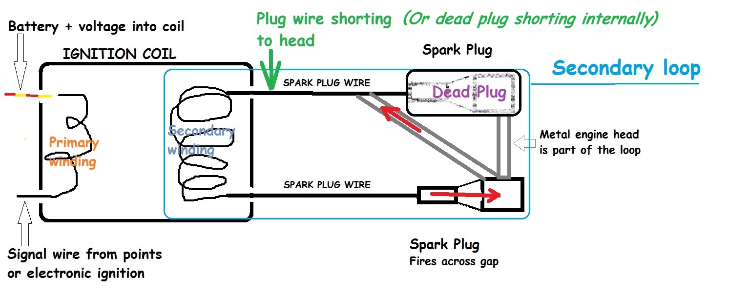

Another possible scenario:
