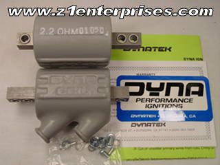

So time for new Coils I have the 84 kz 700 a1 I do beleve it is the IC ignition I dont know how many variations there are of the kawasaki ignition but my bike does not have points. It is my understanding that my stock coils should run 2.0 or close to that so I would want the grey coils is there anything other than a new set of plugs and wires that I would need or need to inspect.
Thanks agen

The as supplied Kawasaki ignition coils had 1/4" push on primary side electrical connections. The new Dyna ignition coils will need new terminations for them to work.
When I changed to the Dyna coils, I fabricated new primary wiring using male and female "WeatherPack" connectors. Now when checkng the valve clearances, I unplug the coils without having to unscrew the primary terminals and lift them out of the way after removing the coils mounting hardware.
#10 RED ring terminals will the primary side of the coils, be careful in not loosing the supplied screws as anything longer will bottom out before it gets tight.
When your wiring is completed, check for possible electrical shorting as the spacers and mounting hardware come close to the primary terminals.
