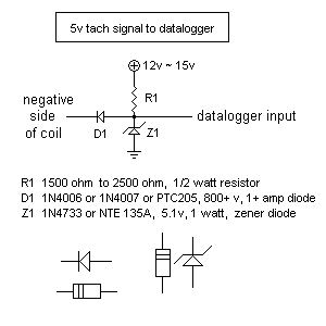

Hey, just contemplating making a datalogger for when I start tuning. I have an O2 guage with analog outs, and I figure I'll hook up a TPS in some way, they're both 0-5V so I'll just throw them into the ADC on my board. Trickier is getting an RPM input. What if I just take the raw signal from a coil, clip it to 5V, and put it directly into a digital input on my board? I used a clipper circuit to accomplish the same a while back with the readout from a hall sensor. That'd probably work fine, right?
Probably going to use PIC micro controller since thats what I'm used to. Not sure if you're into this stuff, wanted to bounce it off someone who might know.

The wire that goes from the coil to the igniter (or points) is a very unique part of the electrical system. It would seem to be just switching 12v on and off, but that's not exactly what happens. When the points, or the igniter, tries to stop current from flowing in the coil, the coil induces up to 600v on that wire. (That's why points arc so much if the condenser fails.)
So you can't really just clip the signal. But I assume you mean to isolate the signal then clip the isolated portion of the signal. That should be relatively simple, but the design will depend on how the input to the datalogger is set up. The only problem I see is if you use diodes to block the high voltage, then you may need a pullup resistor to activate the input in the datalogger. If the datalogger's input floats high, with a strong enough pullup, then you could just use a high voltage diode as a blocker, and a clipping Zener for safety.
Here's the first thing I would try:
The diode blocks the high voltage, but lets the igniter pull down the voltage. It will only pull down to about 2v, so hopefully that is low enough. If not, I'd throw a transistor at it.
The resistor pulls the signal high whenever the diode is not pulling it low. The zener diode clips the 12v down to 5v ~ 5.1v.
At one point Radio Shack would have had all of those parts. They should have the resistor or diode options listed, but the 5v zener may be a problem. If you can't get the zener, the same thing could be done with a resistor, but you'd have to experiment to get the right value since we don't know what the input of the datalogger is like.
