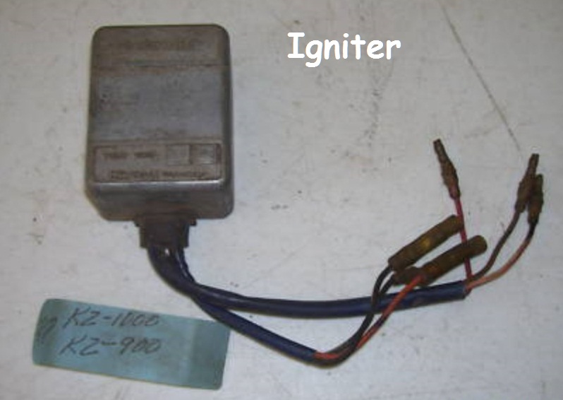

Am pretty sure the stock ignition includes an I.C. igniter, and that each stock ignition coil has primary winding resistance of 1.2Ω~1.9Ω, and that there is also a 1.5Ω~1.9Ω resistor in the battery power wire leading to each coil.
The green Dyna coil has primary winding resistance of 3Ω, and is designed to work with the Dyna-S ignition which eliminates the stock I.C. igniter and the stock resistor.
Where a Dyna-S ignition is used to replace the stock ignition, the stock coils are usually also replaced with Dyna green 3Ω coils.

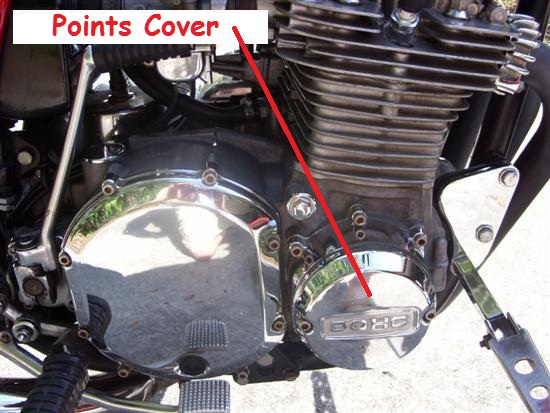

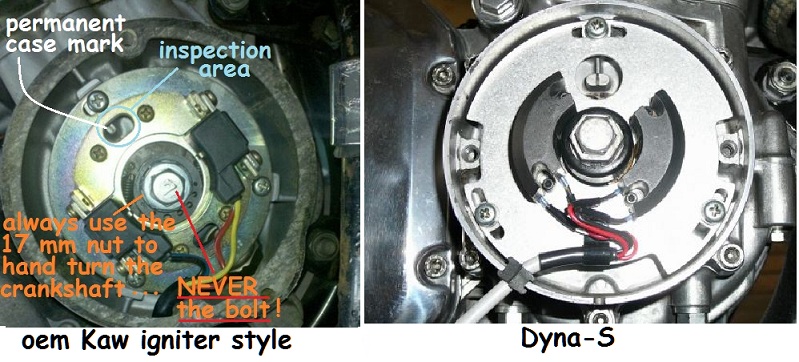

The ignition, either stock or Dyna-S, may be found located under the points cover situated on the right side of the engine.
See pics below.
