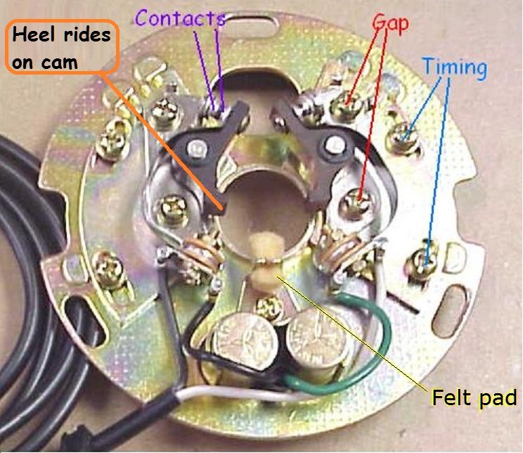

Supposed to dress the contact surfaces as needed and then adjust the gaps before setting the timing.
Here's a large four's points plate for comparison.

That's the same type points plate that my '77 KZ650 has. Some of the later models don't have the individual timing adjustments. They are set up so you must turn the whole plate to adjust the timing of 1 set of points and the other set is 180* away so they should set as the same time. (see pic) In either case, the instructions I listed should get you very close, and as pointed out, do things in the exact order listed - that is adjust the gap before setting the timing. Once completed it is best to check and make any minute adjustments as described in the manual using a timing light and dwell meter if available.
