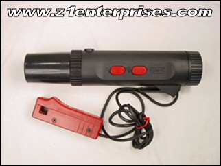

I contacted the Actron manufacturer and they confirmed that none of their timing lights will work with copper core wires. The best part is the tech that returned my email owns a KZ1000 and mentioned KZrider!! Awesome!
So I ended up returning the Actron Timing Light to Advanced Auto Parts and ordered a new one from Z1 Enterprises. The guys at Z1 were shocked when I told them this problem too. Live and learn.

Which light did you get from Z1?
I've had this Snapon Light for like forever, and it has yet to not work on anything. Even use it with a Diesel Pulse Pick-up Adapter for checking Advance on Injection Pumps.

18 May 2011 10:21
