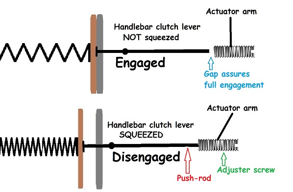

Thanks guys, I've just ordered the part, should be here by the end of the week, but in the mean time, I have another question, the other day I decided to put my bike into first gear and try starting it, so I held in my clutch and bike started moving(moved me about 4 feet,but the engine didn't crank). My question is, is my clutch not engaging? With the clutch held down, shouldn't the bike not move. Thanks again guys.

Clutch plates often "stick" together when a cold engine is started, regardless of squeezing the handlebar clutch lever.
Typical scene is starting cold engine in neutral, followed by "clunk" into low gear as the clutch plates separate. Followed by normal shifting while engine remains warm.
Btw, "engaged" means the clutch plates are being pressed together, and "disengaged" means the clutch plates are separated (usually from squeezing the handlebar clutch lever). See image below.
