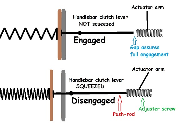

Clutch plates often "stick" together when a cold engine is started, regardless of squeezing the handlebar clutch lever.
Typical scene is starting cold engine in neutral, followed by "clunk" into low gear as the clutch plates separate. Followed by normal shifting while engine remains warm.
Btw, "engaged" means the clutch plates are being pressed together, and "disengaged" means the clutch plates are separated (usually from squeezing the handlebar clutch lever). See image below.
