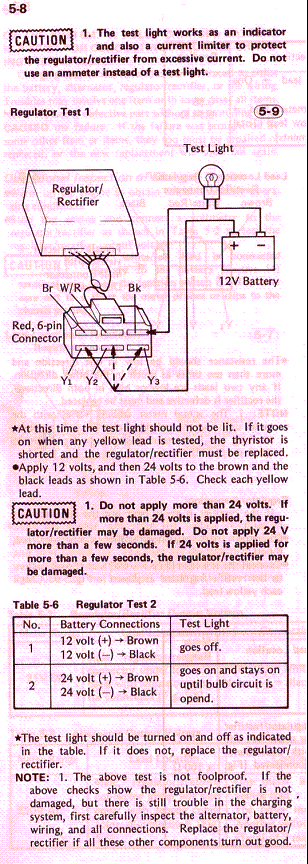

Start with this download of the factory manual.
www.kawiworld.com/index.php?option=com_c...;id=77&Itemid=99
Then you can find out the test values. Remember that there are connectors that can be causing high resistance.
Then this will link you into how to test some of the system, with an AMP meter.
kzrider.com/forum/4-electrical/388730-ju...cking-system-current

A correction on the above stator measurement: I had the meter on the wrong setting. My stator output @ 4k rpm is 4.5vac, 22vac and 22vac so I'm guessing this is where my problem is.

Here's one I made up using my Kawasaki factory shop manual:
Alternator Testing For the Older 4’s(Z1’s,Kz 900’s, Kz1000’s,Kz1100’s and GPz1100’s).
To check to see if the alternator is working you need to follow these simple steps:
1. Fully charge the battery as this will be the power source during this test.
2. Disconnect the Regulator/Rectifier at the plug that has the six wires in it.
3. Start the engine and let it warm to operating temperature.
4. If you're worried about overheating, position a large fan for cooling the engine.
5. After the engine has reached operating temperature, have a helper assist you, and using a multi-meter, read the output at the three yellow wires (or the alternator output wires)at the disconnected connector.
6. Raise the engine speed to 4000 rpm, and see what the three YELLOW wire combinations(or any alternator output wires) are(1-3, 2-3 & 1-2). The output will be around 50 Volts A.C.(Alternating Current). BE CAREFUL, AS THERE IS A SHOCK HAZARD HERE!!
7. If any of the combinations are low or non-existent, the stator(wire windings) are bad and must be replaced.Some of the older Z1’s and KZ900’s were reported to be phase sensitive, so check the wire colors carefully.
8. Using an OHMETER, Check the three wire combinations again, looking for a reading of 0.36 - 0.54 OHMS. If the readings are above or below, the stator may be bad and need replacement. Also check from any of the three YELLOW wires to ground, this will show if arcing took place.
9. Before ordering a new stator, check the connections from the stator as there are electrical "Bullet" connectors that may be damaged or dirty.
Inspect the wiring for signs of shorting or overheating too. www.z1enterprises.com sells replacement rubber grommets for the alternator output wiring, they get hard and could leak oil after a while.
10. Check the wiring coming out of the grommet as there have been situations where the wires were damaged causing a short(I.E. twisted together with insulation damage).
11. The sprocket cover will have to be removed to access the electrical connectors coming from the alternator, the left foot peg assembly and shifting lever will have to come off also.

With 1 leg of your 3 phase stator being so low on voltage I would say this is the problem. Remember that where the wires go through the grommet can be a problem, and the connectors themselves can cause poor contact. Make sure the wiring is OK, maybe the yellow is nearly broken on that leg? Or it could be the winding.

Got my new stator yesterday and got it installed. Good voltage coming from the stator now but still no charging voltage at the battery so it looks like I need the rectifier/regulator as well.$$$
- Motor Head
- Posts: 5137
- Thanks: 393
Re: Charging system on my '82 KZ1100 A2
15 Apr 2011 17:41 - 15 Apr 2011 17:42
These are taken from the FSM I suggested you download, so you can test properly the regulator etc.
[attachment:2]Regulator Testing.htm[/attachment]

Its just that one of the other fellows just found he had a bad ground, @ the Black/ yellow, Regulator to Chassis. Hope the R/R fixes it for you.

I will double check the wiring before I open or install the new part. Just in case. Thanks for the heads-up.
