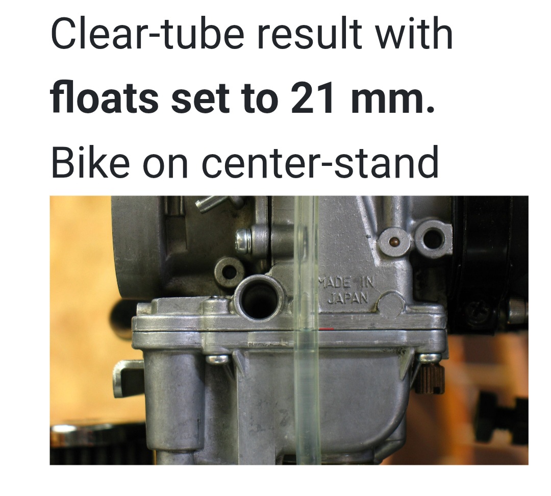

IMO, forget attempting to set RS flatslide carburetor floats with the (3mm below) clear tube method.
It won't work because the RS carb float system is designed differently than BS34 CV carbs, for example.
I have personally owned three different RS series carb sets, and the 17mm +/- measurement method typically produced clear tube measurements around 4-5mm ABOVE the float bowl tops.
Site search result for daveo RS carbs way back yonder in 2017:

Not such a good pic, but this is on the bench at 23 mm, fuel level is now consistent across all 4 carbs, its lower than before and number 2 carb has stopped dribbling, i would sometimes see fuel dropping onto the floor, particulary if using the side stand, Hopefully this is the fix.
