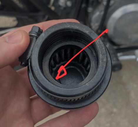

Another thing to check is the quality of the pods you are using. If they have a lip that when fitted covers the pilot circuit air port you'll always struggle.
For your set up i would start with checking the pods. Removing the 50 jet. Use 15 pilots. 105 mains. Airscrew 1.5 turns out / Fuel screw 0.75 turns out. Needle clip 4th slot down from top with air corrector jets fitted then colourtune the warm engine at 1800 rpm
