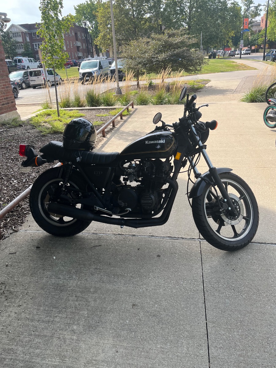

Hey all,
I’ve been fixing up a 1980 kz750 ltd for the past two years and I finally got my license and decided to bring the motorcycle down to college with me. The previous owner did not treat the bike well and ended up cutting off the airbox mounting points, so I bought UNI pod filters and have been trying to make those work (I know pods are super notorious for causing issues). For reference I have keihin cv34 carbs. I also have a 4-1 exhaust that I packed with fiberglass. With the stock jets, it ran very lean and very hot, and wouldn’t hold an idle below 1.5k rpm. It could rev up to about 5k in every gear, but no higher. So, I did research and it seemed like stepping up my jet sizes was the logical next step. I just finished installing #38 pilots, #70 mains, and #140 secondary mains today. It pulls very nicely at lower speeds, except now I top out at 4k rpm in 5th. I barely have enough power to go main road speeds. It will rev to 7k in 2nd now but I can’t get it any higher there either. It idles way better now (~1100) and I can start from a stop way more easily and the bike doesn’t want to stall as readily. Am I running too rich now? Any ideas on what could be causing this? Anything helps, I’m knocking my head against the wall since I can’t think of anything. Below is a list of everything I’ve checked/tried:
- fuel levels are all within spec
- rode with gas cap popped to make sure fuel flows
- checked diaphragms for pinholes, they are solid
- I tried taking the ignition advancer cover off but the bolts are seized and stripped out (so now I’m not getting in there until next summer when I’m back home and can drill them out, plus I don’t think it’s a stuck advancer because I wouldn’t have less power running richer?)
- the pod filters do not block the venturi in the carb intakes
- tried adding the stock airbox back, can’t mount it because of the butchered frame
I was also getting abysmal fuel economy before rejetting (24mpg) and I thought this was because I had to whack the throttle open to get any power. However, I checked and I’m still only getting 24 mpg currently.
I have put so much money into this machine and I’m starting to hate it because it breaks down so often. I was thinking that a #130 or #135 secondary main jet might be worth trying instead of the new #140, but I really don’t want to spend more money unless someone can confirm that that is my most likely issue. I unfortunately have limited money and limited time I can spend removing and reinstalling the carbs.
tldr; I run pod filters on my bike so I rejetted and somehow lost even more power. I’m a broke college student. What should I do?

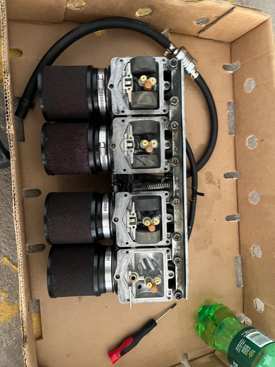

I have a kz750 E1 with Keihin CV34 carbs like yours. I've had K&N pods for several yaers and that 70 140 jetting was just fine. I got rid of the pods after getting caught in the rain. Cough chug splutter splutter.
Honestly my first thought was that the uni pods had a lip inside blocking or even partially blocking air jet or passage but you say no. It does sound like a restriction and wondering if the rich condition is because of fuel excess or air deficiency .
Have you tried running without the Uni pods just briefly ?
Perhaps some other carb blockage ? Have you given them a thorough cleaning.?

14 Sep 2026 16:36Well, the packing can't be blocking the main flow path or the engine won't rev.Someone else can comment on the fiberglass packing. I dont know what the effect might be.
