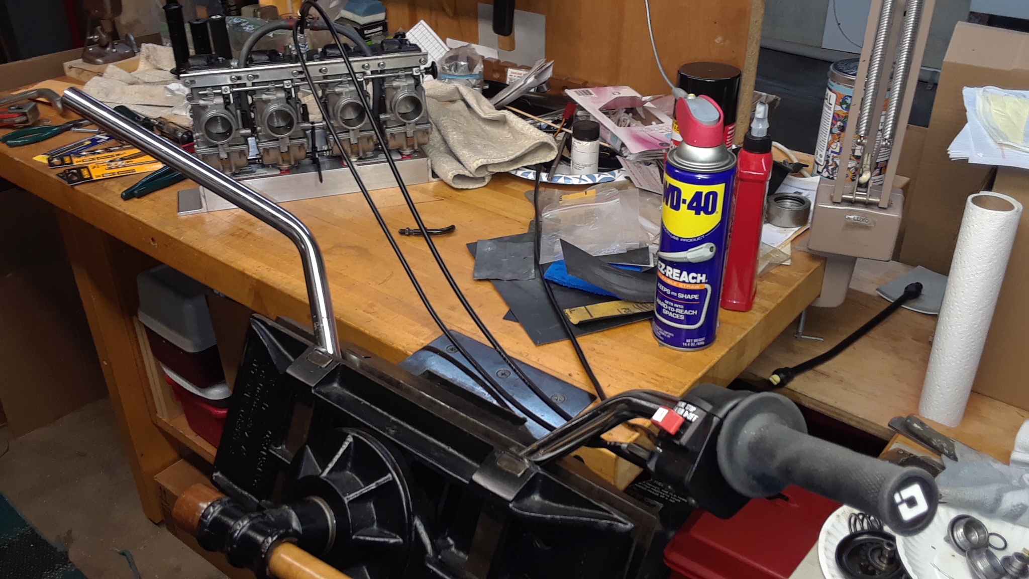

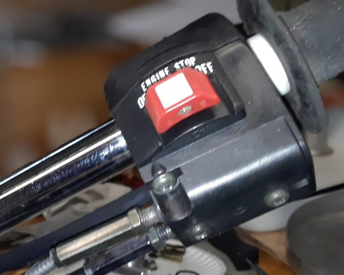

My 82 KZ1100A has RS34's operated with a dual-cable throttle housing from an 85 Kawasaki ZN1100 purchased off ebay about ten years ago.
Last year I picked up the unit shown below for backup:
I could not find replacement cables for the Kawasaki control, so a set was made from different new cables with reused original components.
It was worth the effort to maintain the stock wiring harness, and original appearance.
