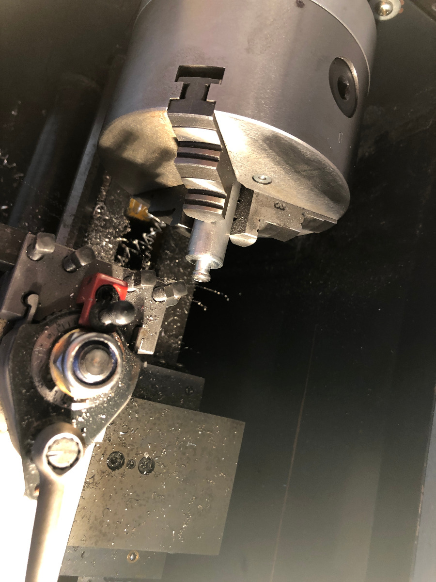

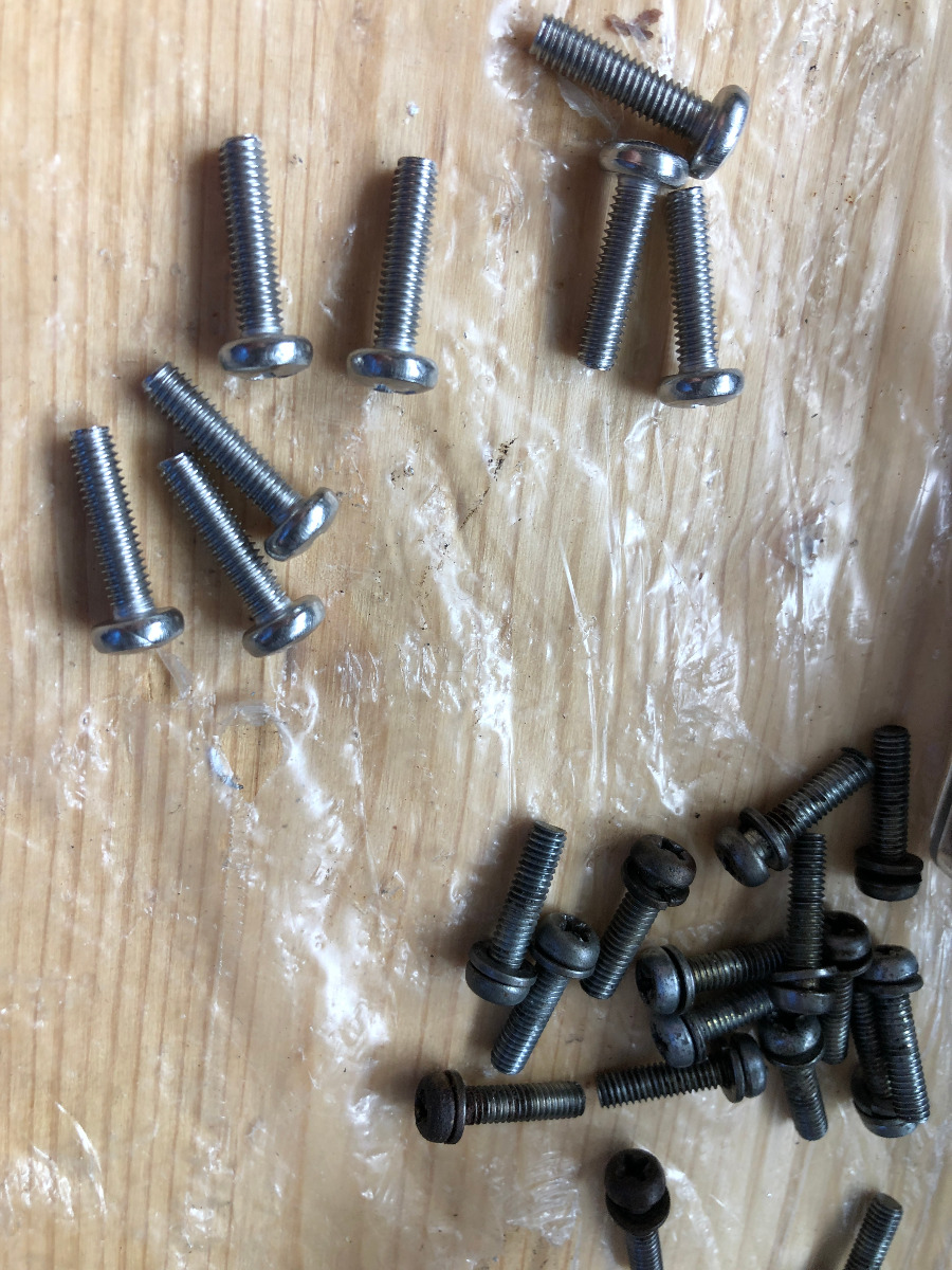

I wanted to fit my carburetor assembly with new Phillips-head screws... but because I was too "stingy" to spend 25 euros plus shipping on 24 "near-original" screws (zinc-plated steel), SO, I bought 50 "non-original" M4 x 14mm stainless steel screws for 5 euros instead. —
BUT: The heads on these screws have an 8 mm diameter, whereas the originals are 6.8–6.9 mm... So, I fabricated a jig to hold the screws and turned the 24 I needed down to the correct diameter... It’s a good thing I still have my small lathe in the garage... it was raining here today anyway... Still, it remains a "moron's job"—but that's what you do when you have to watch your pennies...

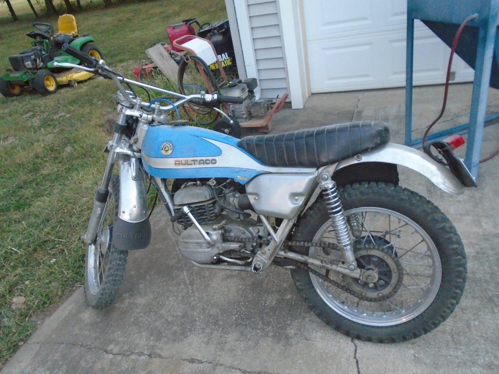

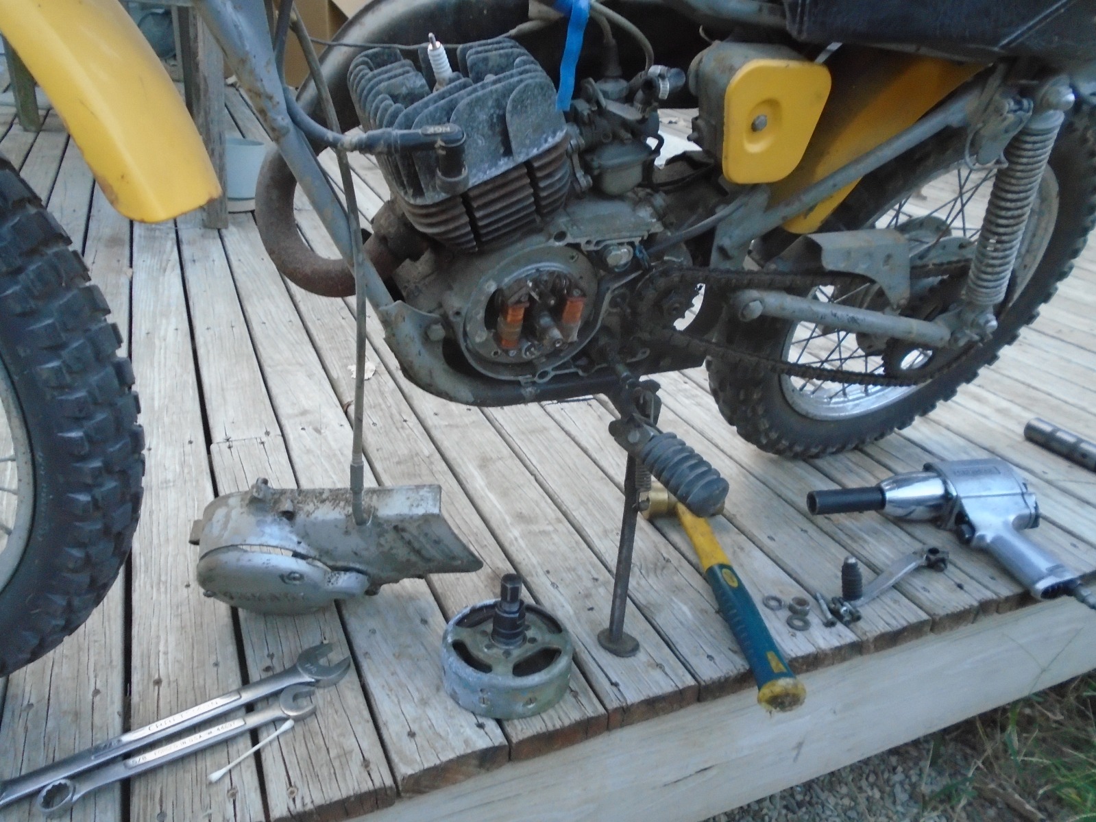

I've not had a sound/decent night's sleep in years. But have always been an early riser, plus it's been in the 100's here so taking advantage of cooler morning temps and lower humidity. Gotta wake up early to keep-up. A school hood friend brought me a couple projects yesterday. Always something unique and antique ha. Bultaco for crankcase pressure/vacuum seal testing and little Yamaha no spark. Prefer to work in the dark then the blazing beating summer sun,

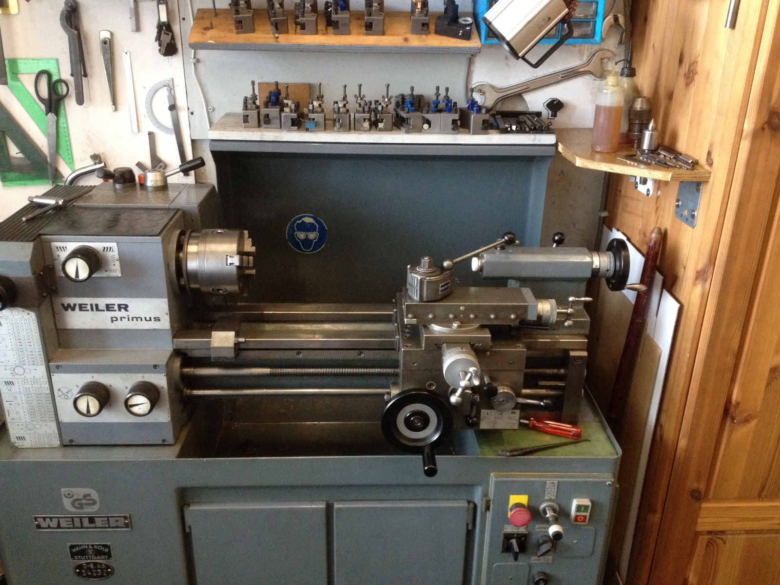

(Yes, I couldn't imagine life without a lathe either! It really broke my heart a bit when I started dismantling my commercial workshop earlier this year; selling my excellent Weiler Primus lathe—with all its feed options, collet setup, and great versatility—was incredibly hard for me!!!)

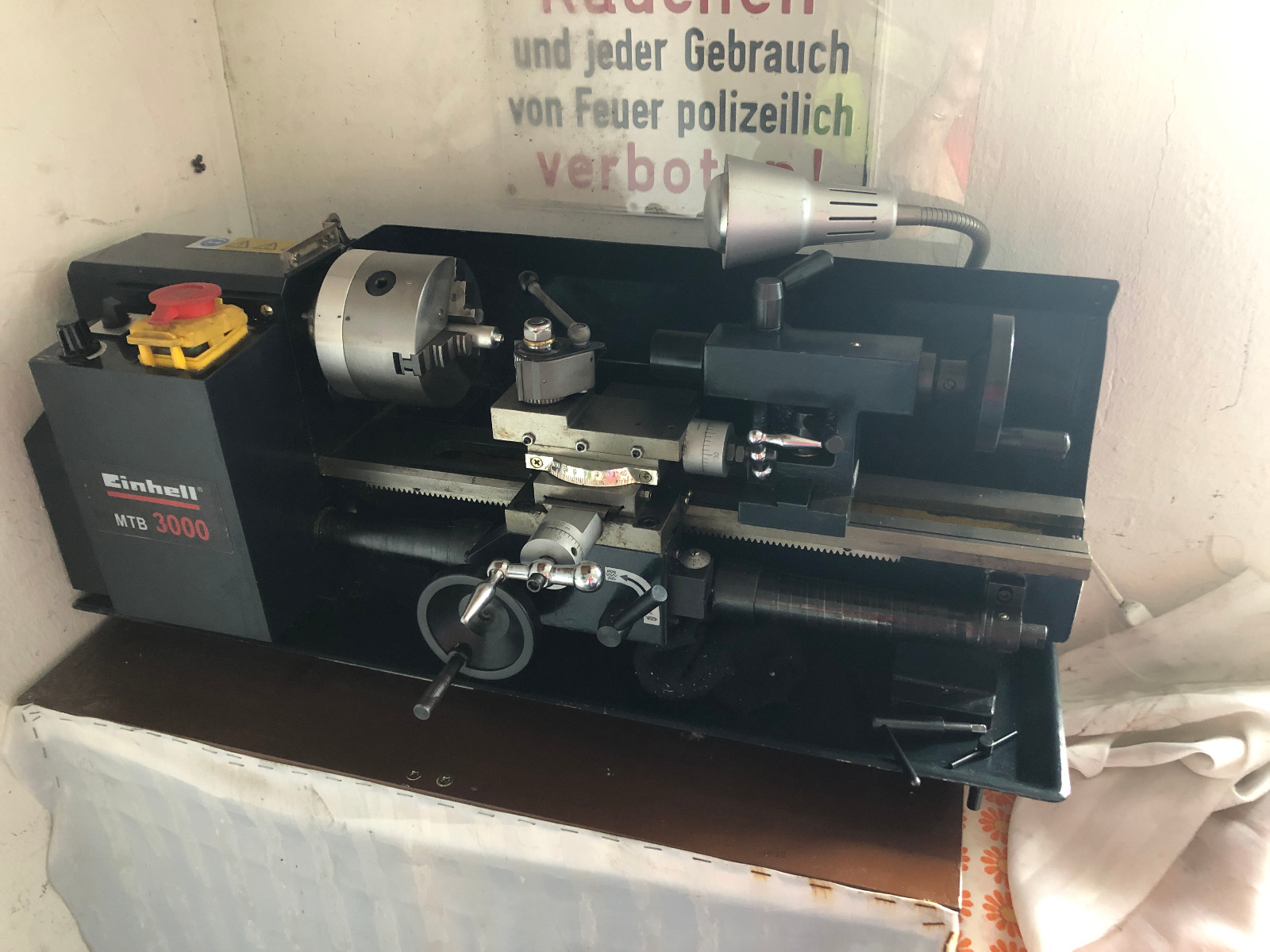

Luckily, I had the foresight to buy one of those small Chinese mini-lathes for my garage two years ago. I could already see back then that I’d likely have to dismantle my workshop in the coming years—and as I said, I couldn't—and didn't want to—imagine being without a lathe. I do as much as possible myself, or tinker with improvements, and sometimes it’s simply necessary to fabricate a bushing, shorten screws, or make parts from scratch... the little lathe is perfect for that!
*That* was my Weiler lathe: fully equipped, featuring a switchable magnetic brake (the chuck stops instantly upon stopping), longitudinal and cross feeds, a full set of change gears for almost all thread pitches (metric and imperial), camlock-quick-change 3-jaw and 4-jaw chucks, collets ranging from 1 to 20 mm with a quick-clamping mechanism, a steady rest, and so on. For me, it was the ultimate lathe for working on motorcycles and cars!
But this little chinese lathe, ( i´ve equipped it with a larger Ø 100 mm chuck on an selfmade adapter, and a "quick-changer-toolpost"), is still ok for me, and the most things, i´ve need to do....per example, last months the bushings and rods, i´ve fabricated for my footpeg-system... I am happy, to have this little bastard!!!
