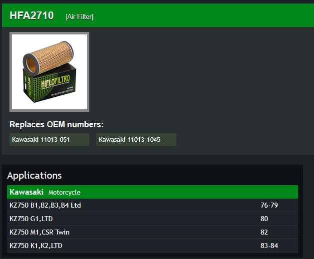

If that filter is in the right way, I think you got the wrong part. Before I'd go trying to remove anything from up under that airbox, I'd get on
here
, change the model to your bike, find the part #, then do a google search and cross-reference the factory part # with the one you have, to ensure whether it's correct or not. I can't see any way that one will fit, even if there was something not assembled correctly in the bottom of your airbox.

27 Jul 2026 22:31 - 27 Jul 2026 22:32Kawasaki shows at least two different part numbers for those models.

z1enterprises is showing the same air filter for all of the 750-Twins. not surprising. as they're all pretty much the same. Kawasaki has a different part number for the 750m/k models but the filter probably supersedes the earlier part. kaw probably made a minor change then upgraded the number to their newer 4-digit suffix that seems to be used on most parts afte the 70s.

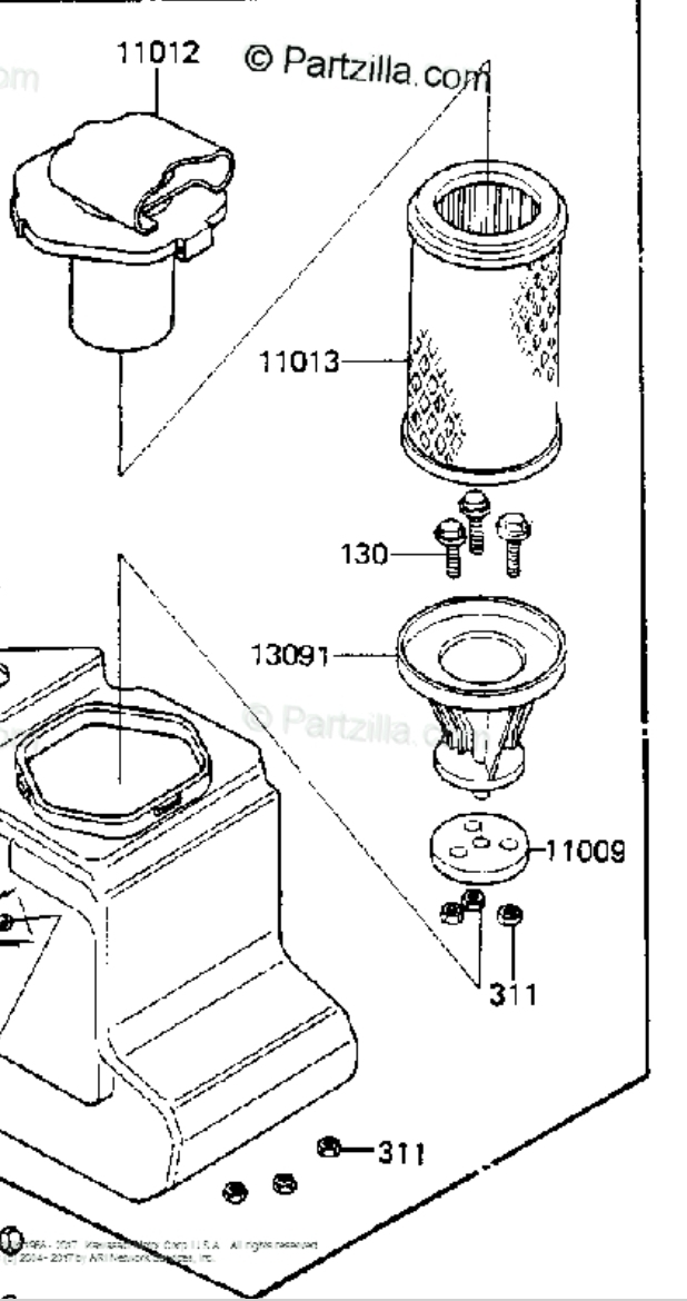

01 Aug 2026 08:15 - 01 Aug 2026 08:20According to a online parts supplier that bottom holder part is the same on all 750 twins, looks like they never changed it.RippyTheRazor post=926275 userid=83514I've attempted to put the air filter in every way except sideways, no luck. Attached is the measurement of the filter, could I possibly have a form user measure theirs?
I'm beginning to think that the bottom funnel piece (Drain? Secondary air intake?) may be from the wrong year, as my airbox came disassembled. Anyone know/have a spare 1983 piece? or know where I could find one?
Thanks again
Its still in the Kawasaki system available to order new from a dealer. Its also a very unique design with the strengthening ribs on the one side only.
The KZ650 holder is a lot shorter with no bolt holes.
If the bottom gasket is foam like on the 650 you can make a tiny bit of space by removing it. Most of those eventually turn to dust.
Is it possible that the pipe part of the bottom holder is not going thru the hole in the bottom of the air box?
