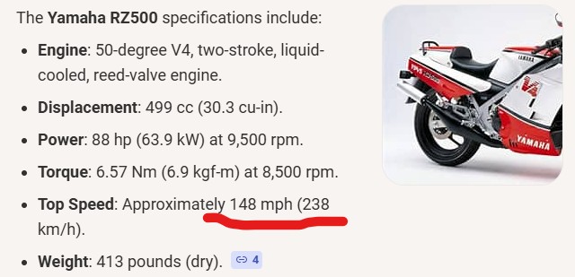

Have you ever ridden a fast motorcycle Wookie? Like one made in this century? Cause an RZ500 ain't one. Also 150 mph? Maybe on the longest downhill and with a serious tailwind.

Wow, slap! Not everyone is concerned with warp speed or dependance of/on external validation of such behavior chopper. That's not the main focus of this forum anyway. Riding at any speed is fun. Subtle back-handed remarks noted. You would tell us if you developed excessive self confidence from a stroke wouldn't you, right?
