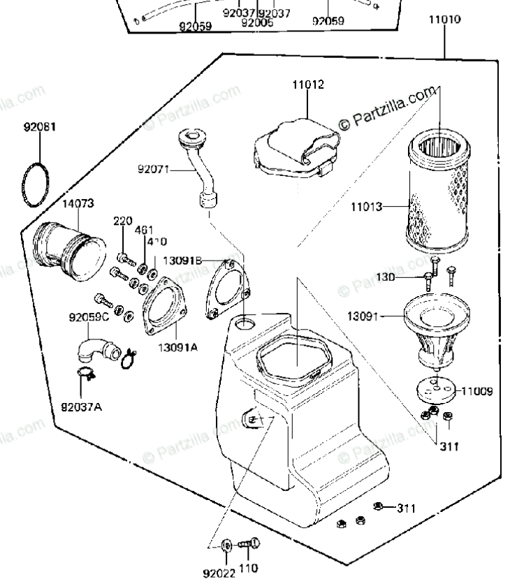

There is a reason people tend to convert to pods, and your situation is a prime example, not that I recommend it. Maybe send pictures of your problem and we can go from there? I know it can be a pain in the trunk. does your airbox look like this? The image may not help. There should be a serial number on the airbox somewhere. If it has one, could you share it?

from the parts diagrams. the 82-84 750M/K Twins use the same airbox assy. the 76-80 750B/G have a different part number and although similar in shape the drawing is different. the 2 different types share some of the same components. it would be suprising to me if they aren't interchangeable. but maybe they aren't. in case you have the wrong one.
