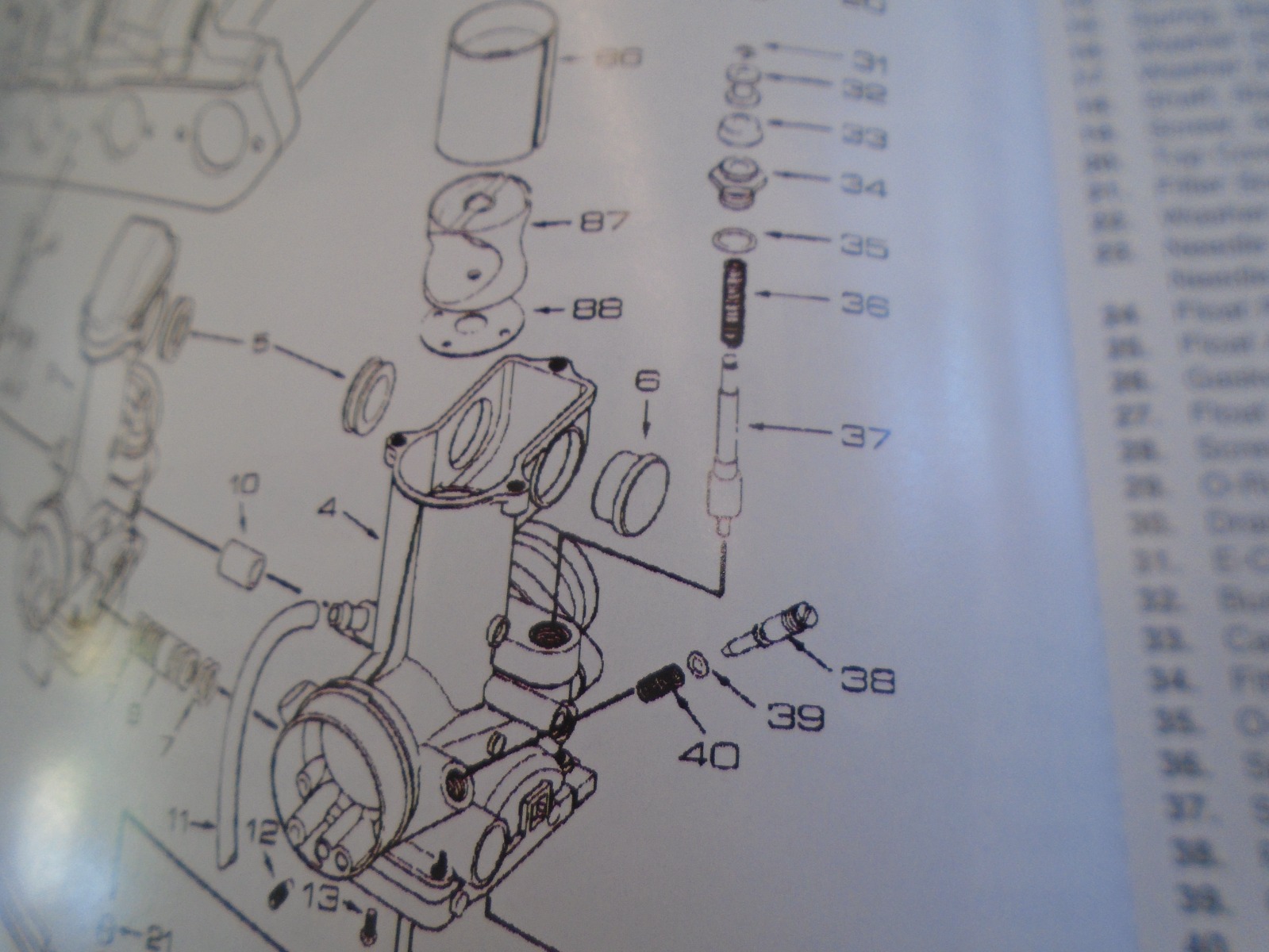

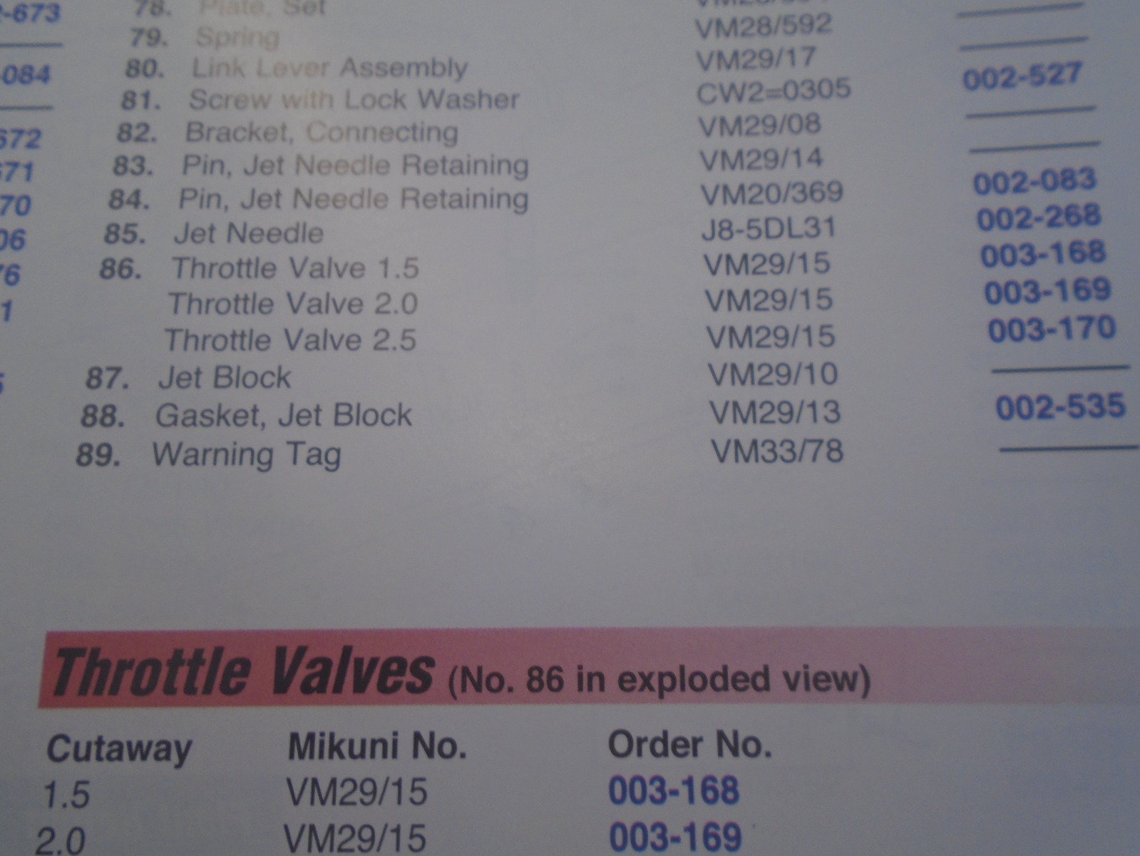

Aggravating for sure. I've never used that "wire" initial slide
setting thingy so irrelevant to my process. Because the 29's used a Jet Block, have you had it pulled out? A critical thing about when using these is having a "sealed" Jet Block/Gasket/Casting assembly. The vacuum from venturi won't pull up the access of fuel from pilot if not sealed. These gaskets are paper thin mind you so castings and orientation when assembly is critical. Don't tighten that little Phillips headed screw down unless you have the slide in place. And make sure the gasket is correctly placed so "hole" in gasket is properly positioned for fuel flow from pilot. I've always used a small drill bit to position them as i lower the jet block into position. Overall, sounds like a pilot fuel issue. I take an unorthodox approach when cleaning carbs, i water blast the galleys. You can witness the flow when doing this. I know i'm bizarre and do goofy stuff..but it's better then just shooting solvent down a hole. Also because the Air Screw is unique to these make sure the hole in the end is free and clear. Some additional photos for Your 101 class of study ha.
