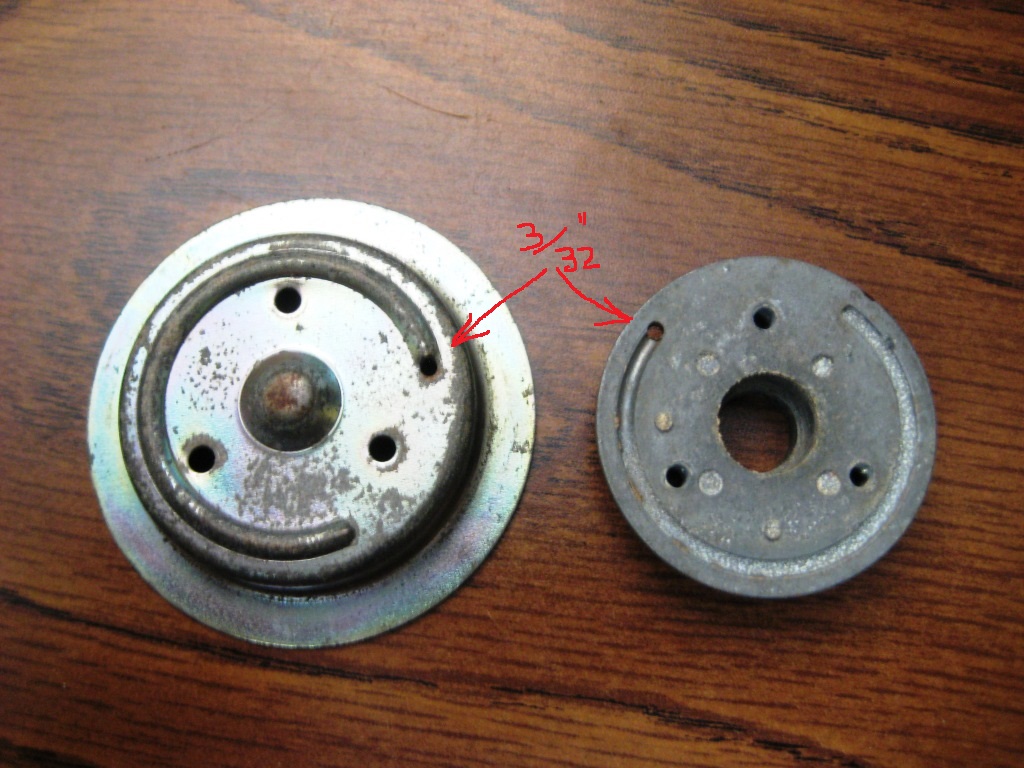

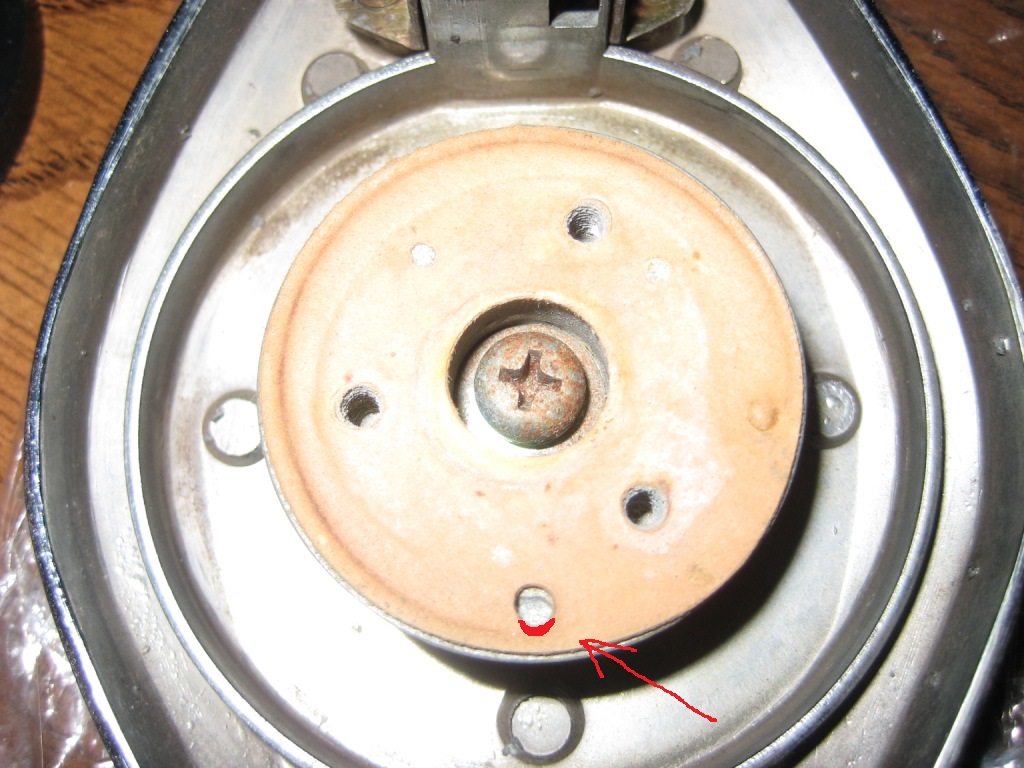

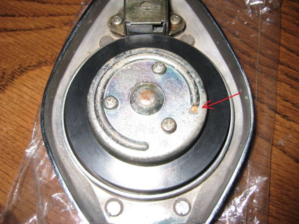

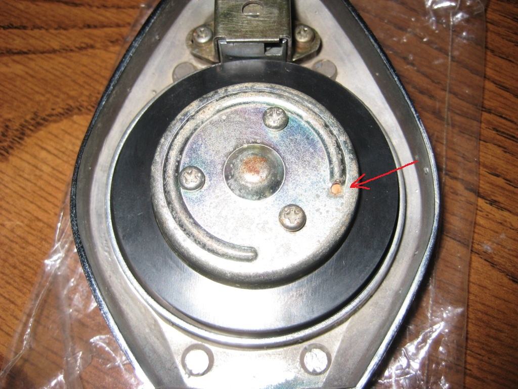

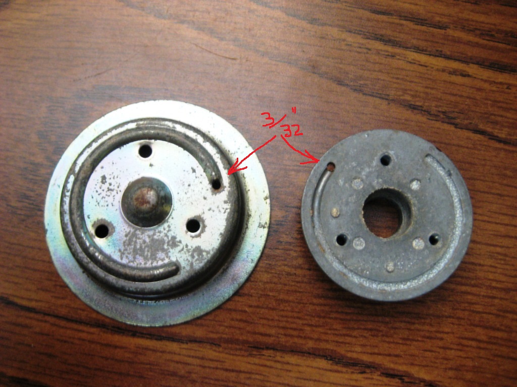

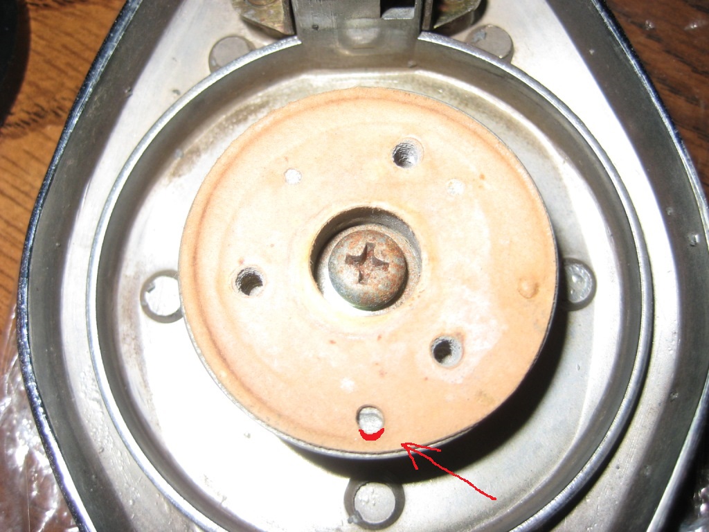

I have taken a couple apart on a KZ650 (same PN as '76 KZ900) and drilled out the "vent" hole bigger in the steel/aluminum and opened up the corresponding hole in the paper gasket.
My 831cc engine with 33mm flat slides runs hot and if its 34C out you could hear it hiss when you came to a stop. After the cap mods the hissing stopped.
FYI - You do need to be careful when pulling them apart as there were no spare parts ever available except the rubber gasket as they were just sold as assemblies.
On one I took apart there was a small yellow spider dead in the vent "tunnel" basically blocking it from venting!
The first pic is the stock cap - note how there is hardly a opening for air to escape. On the one in the pics the paper gasket was mismatched to the steel hole, so blocking slightly. I also polish the aluminum cast "track" to make it smooth. On the third pic you can see how its "ported".
This was a 40 year old cap that I put a new gasket on. So far I have done this mod to 3 gas caps, one I have ridden with for 12 seasons and the other for 10 seasons with zero issues.
I am not sure if this will alleviate your issues, but it can't hurt.

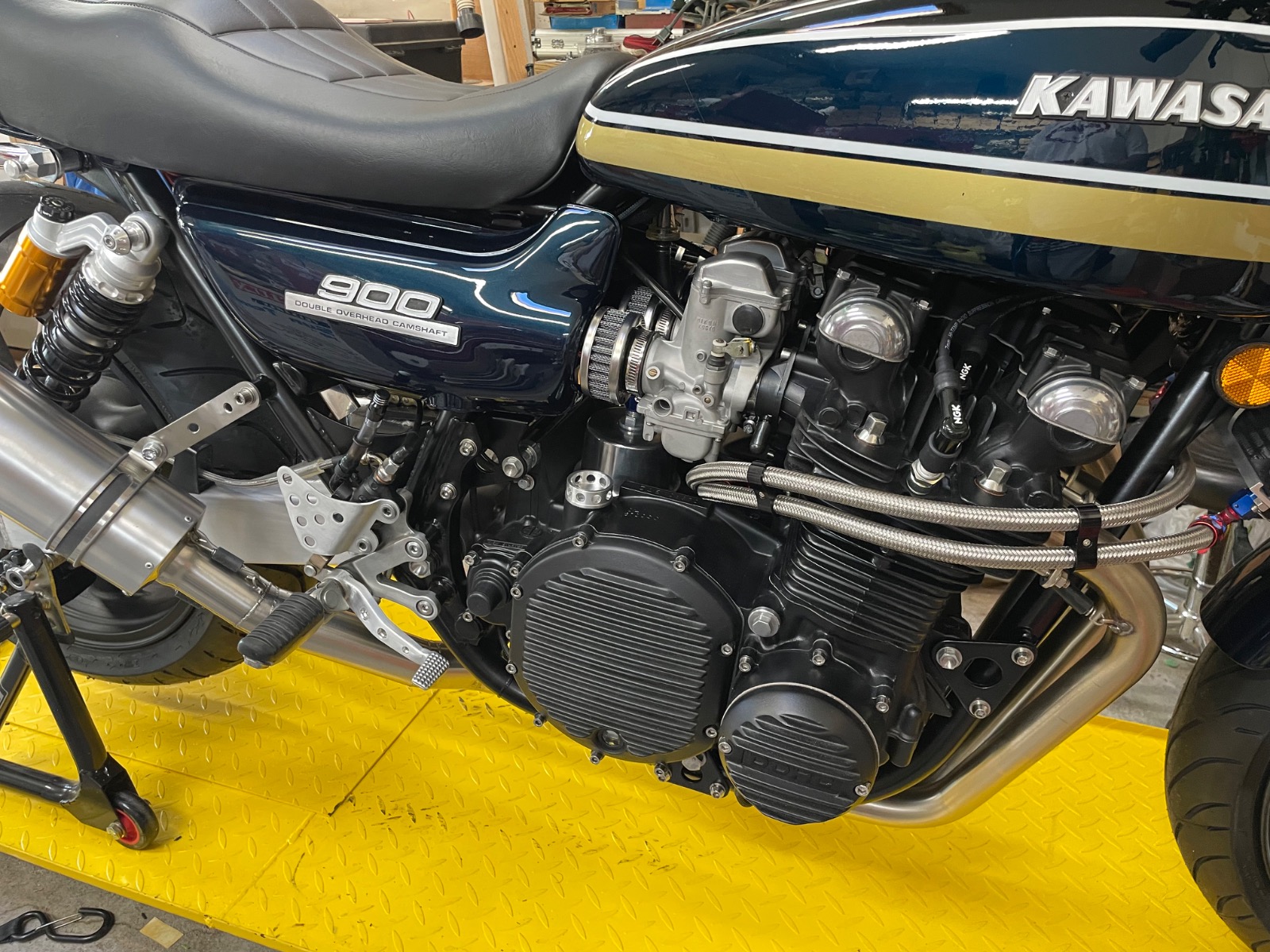

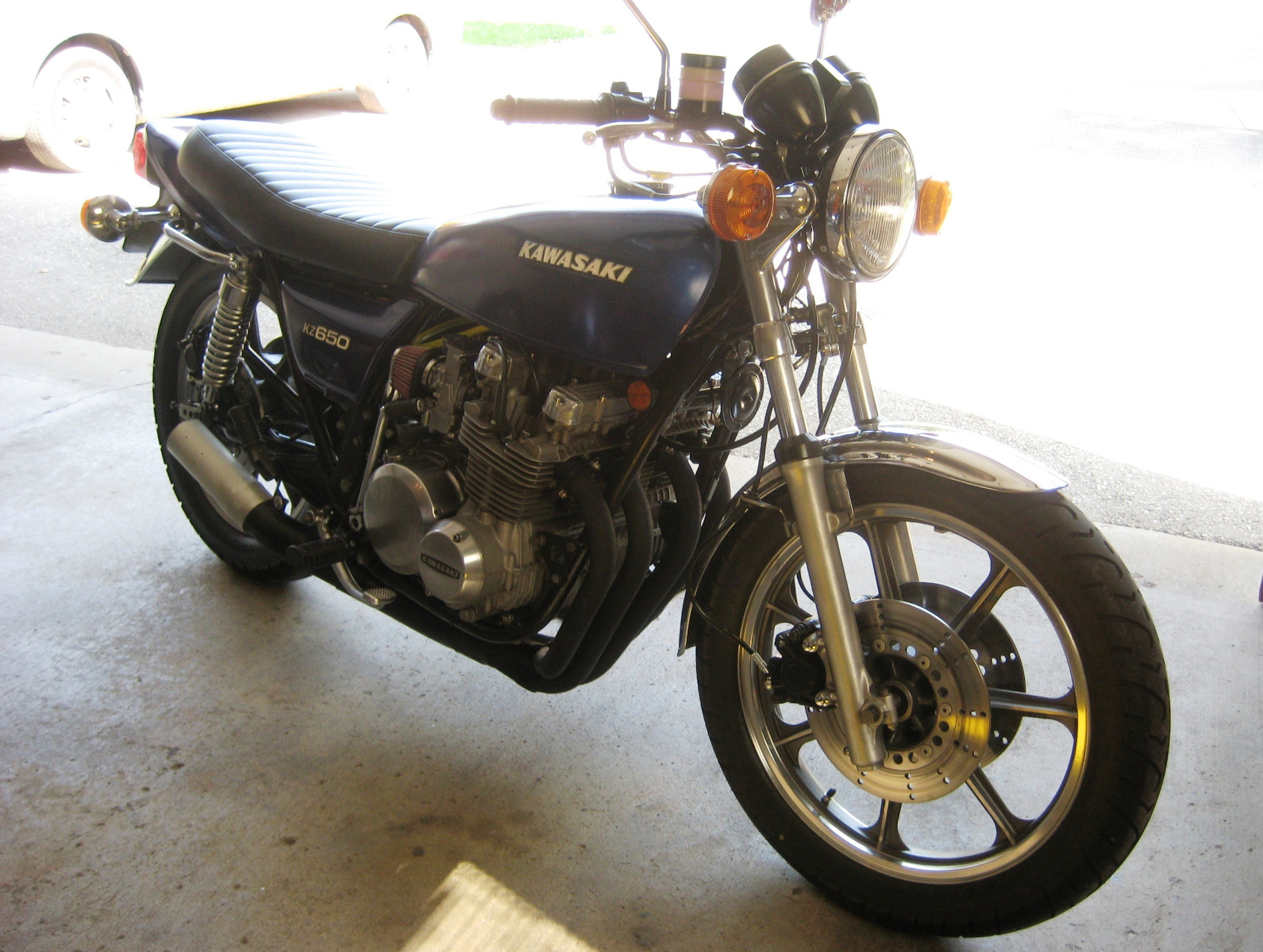

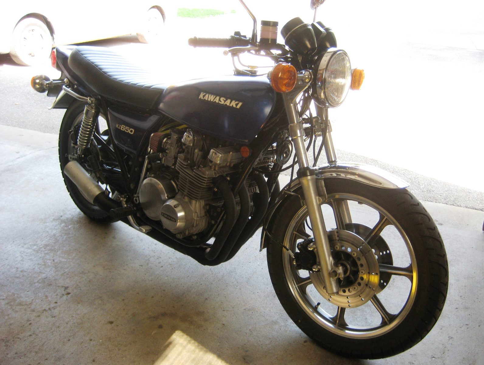

I am in Ontario and got a KZ650 safety checked 5 years ago. I told them up front that I restored the bike and did the work myself. Maybe because of this they were pretty lenient about the way it was running (bike in the pic below - 831cc w RS34's) It had a slight weep on the rear caliper and the idle screws were set a bit rich. Just bench synced the carbs.
They just asked me to fix that stuff and signed off on it.

Well, there’s another one for the books. Composite gasket under flange that holds gas cap seal was wrong, good call. There was no way it ever would have vented much as found, and couldn’t orient the holes so drilled new and reassembled.
Should be rolling now.
