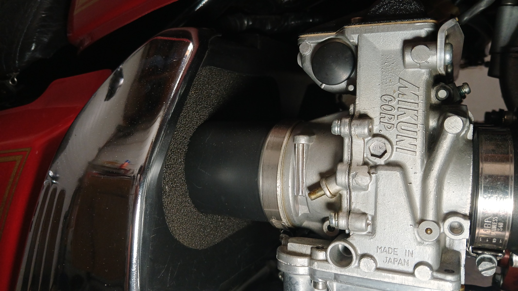

Air box setup:

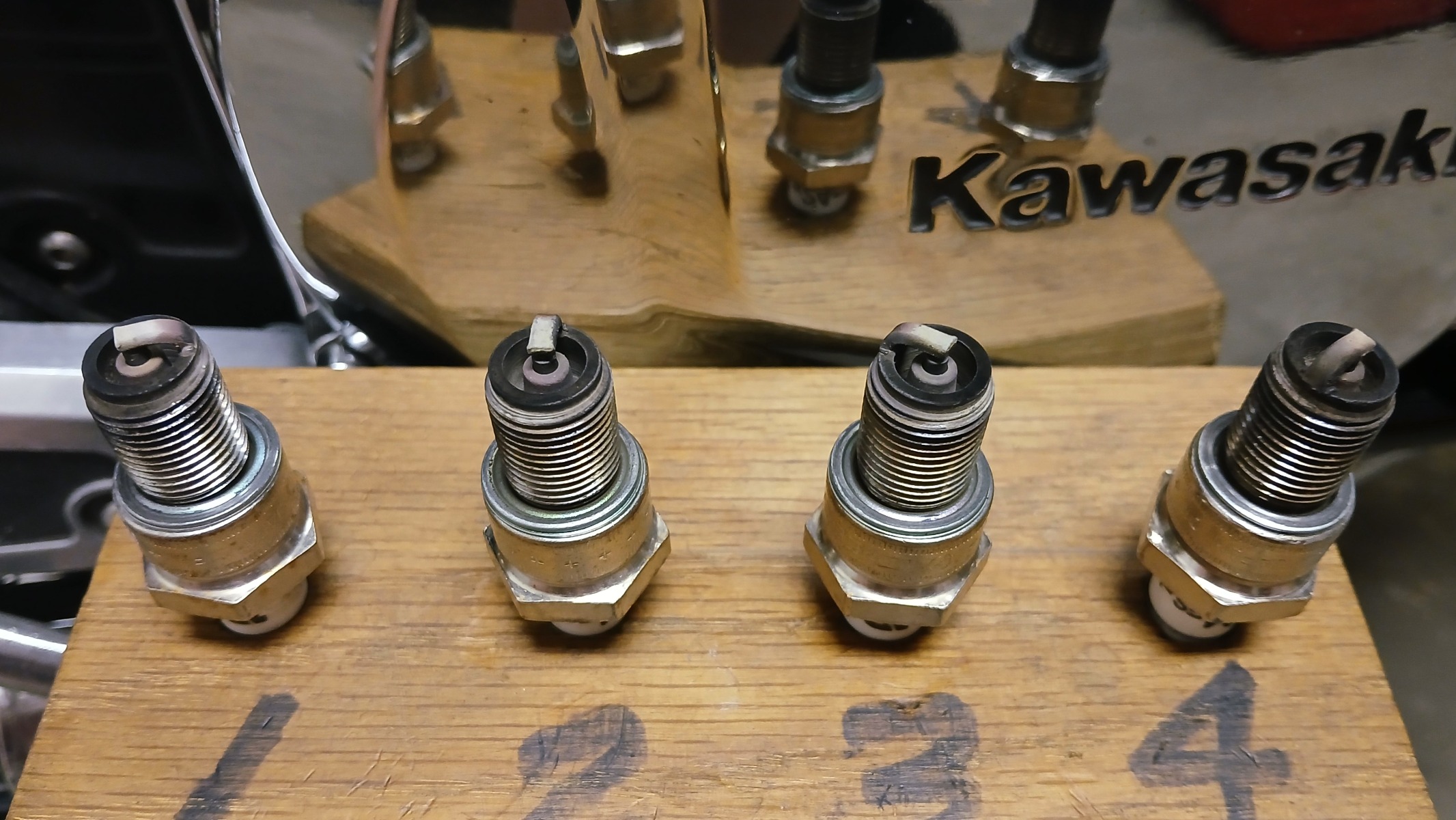

ND W24ES-U plugs:
Current Jetting:
Main: 125 1&4
127.5 2&3
Pilot: 25
Air: 1.0
Considering 1.1 air jets to lean out the mix slightly, but I don't know if it's needed at this point with 60°~80° F. average air temps.
Maybe I should wait til later if/when Summer heats up here.
ND W24ES-U plugs:
Current Jetting:
Main: 125 1&4
127.5 2&3
Pilot: 25
Air: 1.0

Those plugs look lean enough, especially 1,2 and 3.
4 looks better with a little more soot on the base ring and tan on the ground electrode unless it's the lighting.

Yes, plug 4 was slightly rich since the top-end was redone (roughly 1500 miles ago), but has gradually improved to where it is now similar to the others.
Compression is 180 psi. ×4
Deceleration is smooth/popless in the mid 70° F. (low humidity) air temps, and becomes subtle when the air cools to the 60's.
