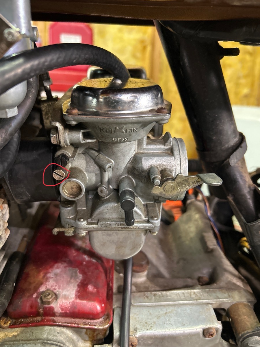

I was thinking the same thing but I still need a set for my other 76’ as well. The current one I’m working on is in better shape so I feel like a new set would be nice in my opinion! How can I find the help? Attached a photo for reference - Looks the same on the other side as well.

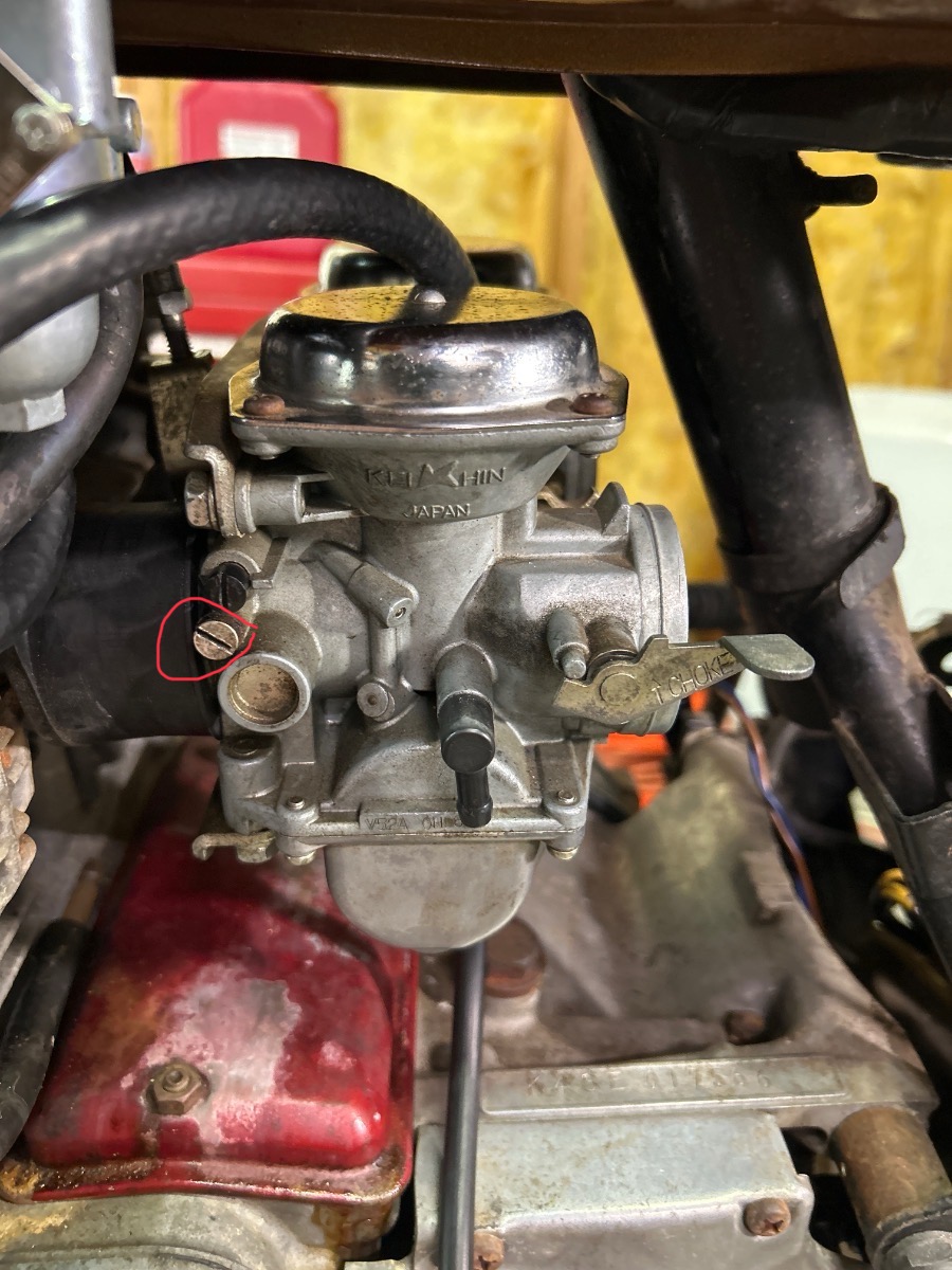

Thank you! If you see the carb photo, which is my fuel mix/ pilot screw?

The brass screw circled in red is the pilot mixture screw. There is one on each carburetor.
it is one of the last adjustments to do when tuning the bike. Several things can cause a rich idle mixture and all the others need to be taken care of first. Trying to use the mixture screws to mask some other problems will lead to increasing frustration and sadness.
