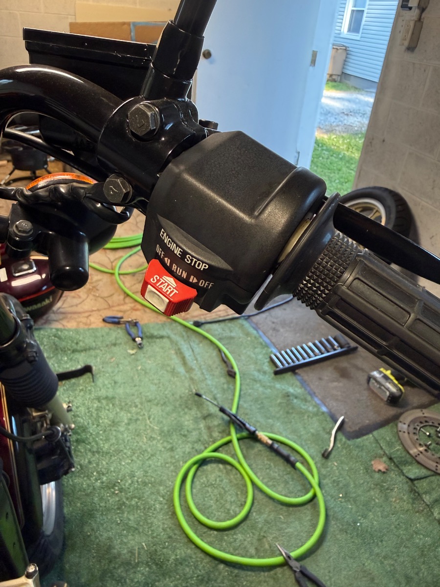

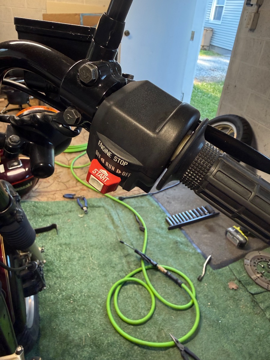

Another option is to use the switch housing and twist grip from a later model Kawasaki. It will not look identical to the original, but you should be able to find one that is similar enough to look like it came that way. You may have to fiddle with the electrical connectors a bit, as the wire colors and connectors may be different.
I have controls from a 1995 GPz 1100 for my build.

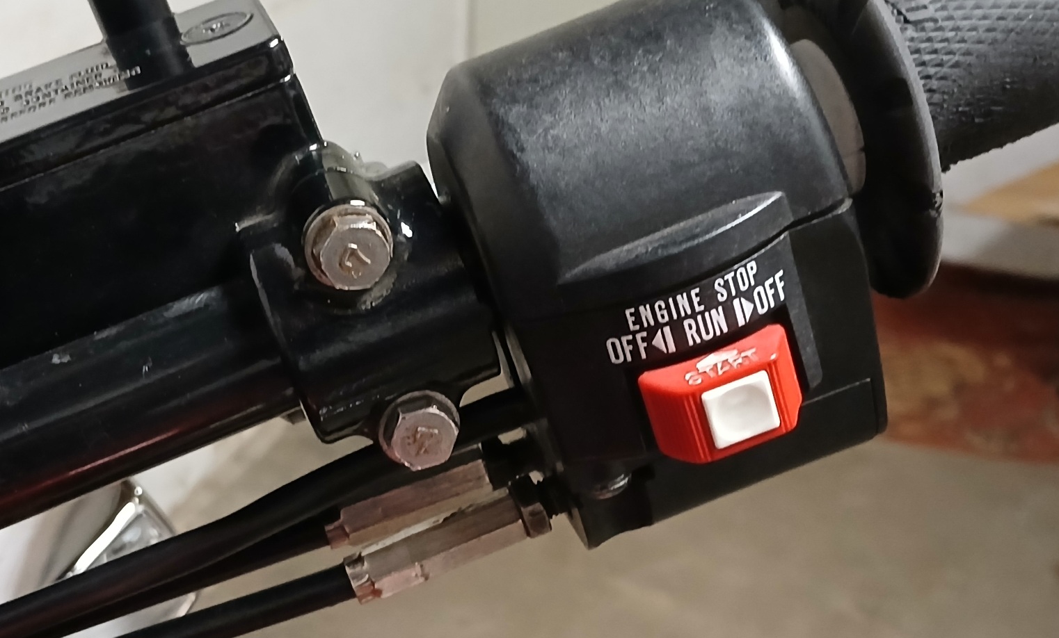

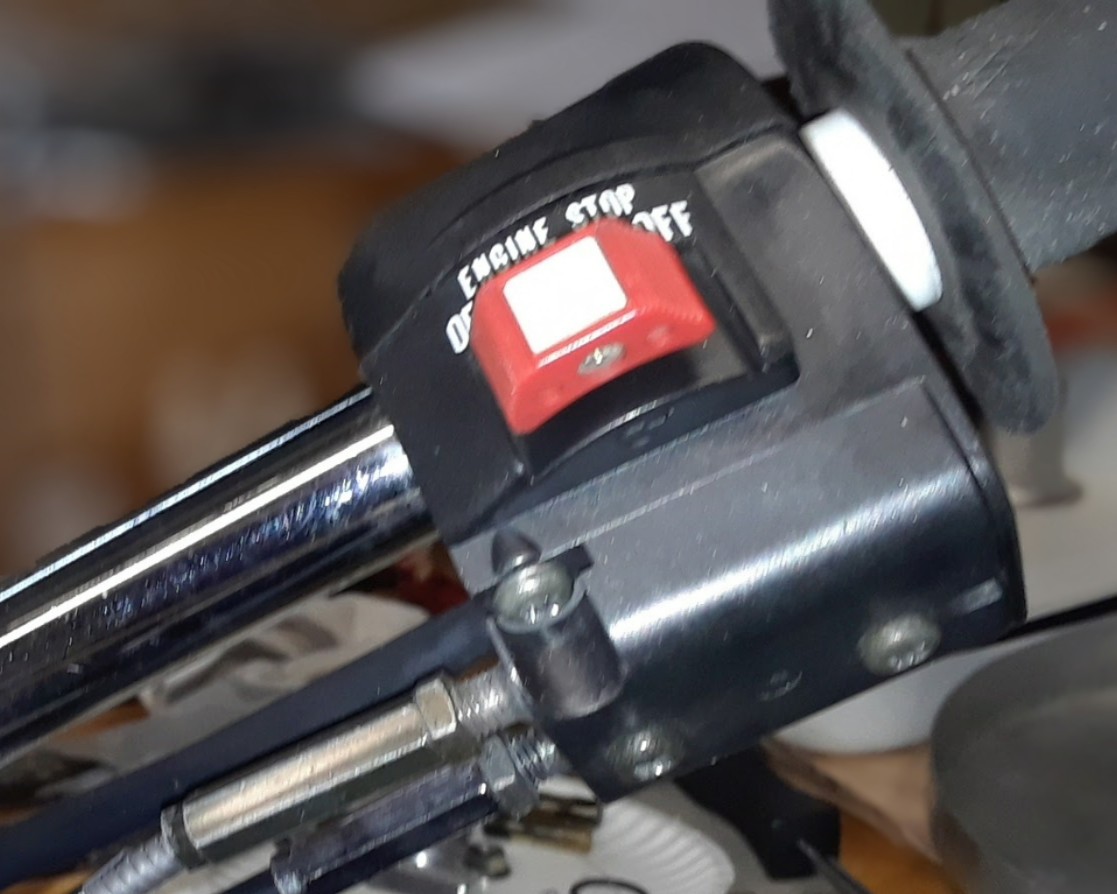

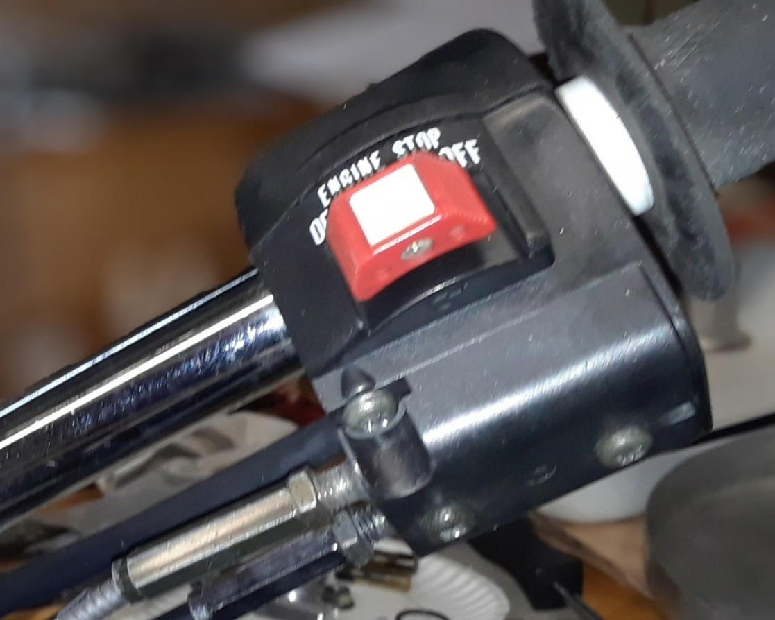

Hard to find dual cable control from a 1985 ZN1100
Constructed two cables with old OE elbow fittings adopted to new Motion Pro cables for the KZ1100A model, with new throttle-end knarps:
*Note: The 82 KZ1100 wire harness (w/internal switch) was easily swapped in, with NO modification required.
1982 KZ1100-A2/1170cc sleeper 😀

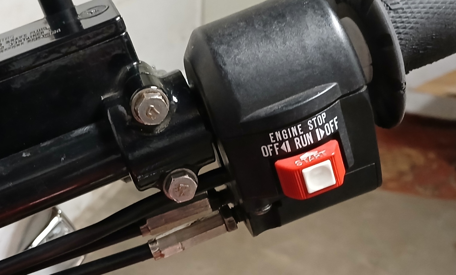

11 May 2026 08:09 - 11 May 2026 08:10+1 - I am using ZX6R switches and a ZX1400 throttle converted to single cable for my BS34'sAnother option is to use the switch housing and twist grip from a later model Kawasaki. It will not look identical to the original, but you should be able to find one that is similar enough to look like it came that way. You may have to fiddle with the electrical connectors a bit, as the wire colors and connectors may be different.
Last edit: 11 May 2026 08:10 by Wookie58.
