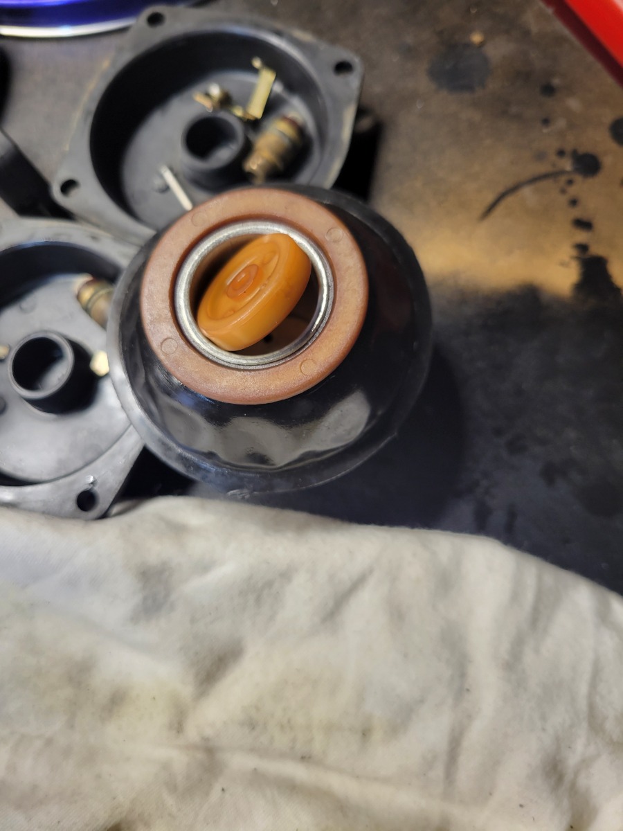

I took it apart and the main plungers on the inside where the needle is that part is very stiff it don't want to move I don't know maybe it's not supposed to move you guys let me know
also I took the pods off and there's all kinds of gas inside the pods why am I leaking so much gas and three of the Four carburetors

Those plastic discs don’t move in normal operation. Gas in the pods is likely float heights wrong or float valves not closing
