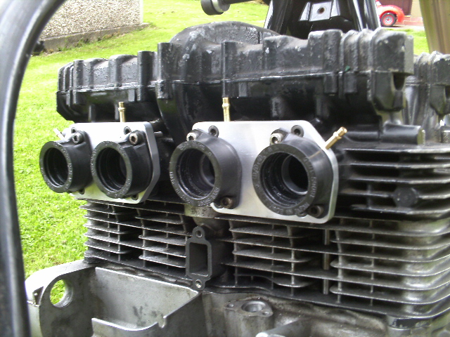

Hello Guys, having a question.
I bought some mikuni smootbores 34 mm. I was working to mount them, but there are no connections for vacuüm meters on the, so i cant synchro them.
My manifolds (Z1000j) dont have them either. I seen that older Z models have manifolds with vacuüm tubes, but i understand that these wont fit on a J model. You guys have any idea how to solve this?thanx

On my latest build i used 1000 katana 32mm ovalbores and J rubbers both of which have no vac ports so made these adaptor plates which incorporate them.
The plates were initially needed because the bore spacing on the carbs is different to the head .

Hi Zed,
Very useful solution. And beautiful well made

They are available as i have them on my 1981 euro spec j with original carb to head rubbers.

Ok Thanx Warren. That means I'll can find them on CMS? I will scoop around
