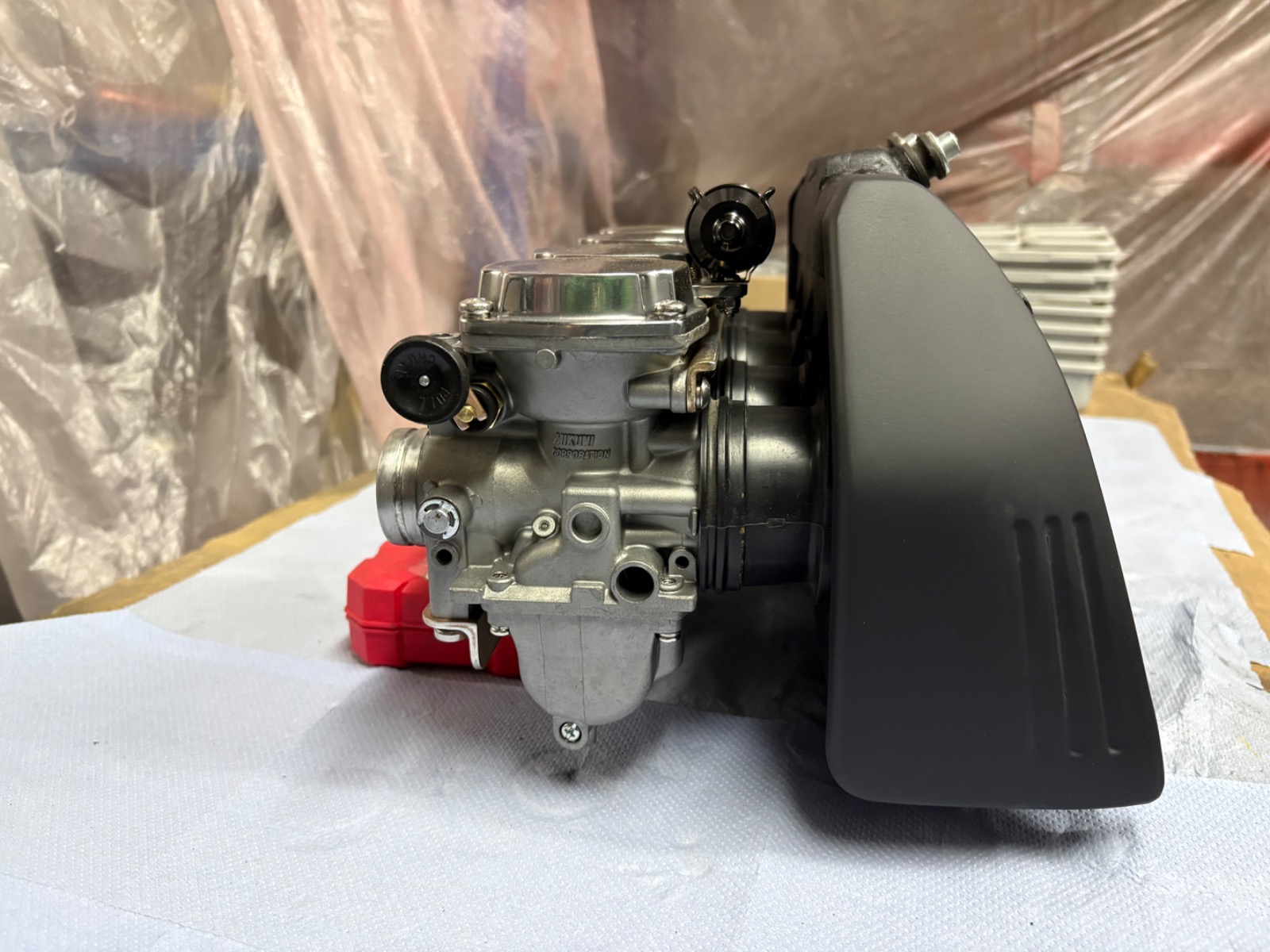

Hello KzRiders, can you recommend a brand for polishing and cleaning carburetor bodies?

Ultrasonic clean then vapour blast, I have clearcoated with cerekote
