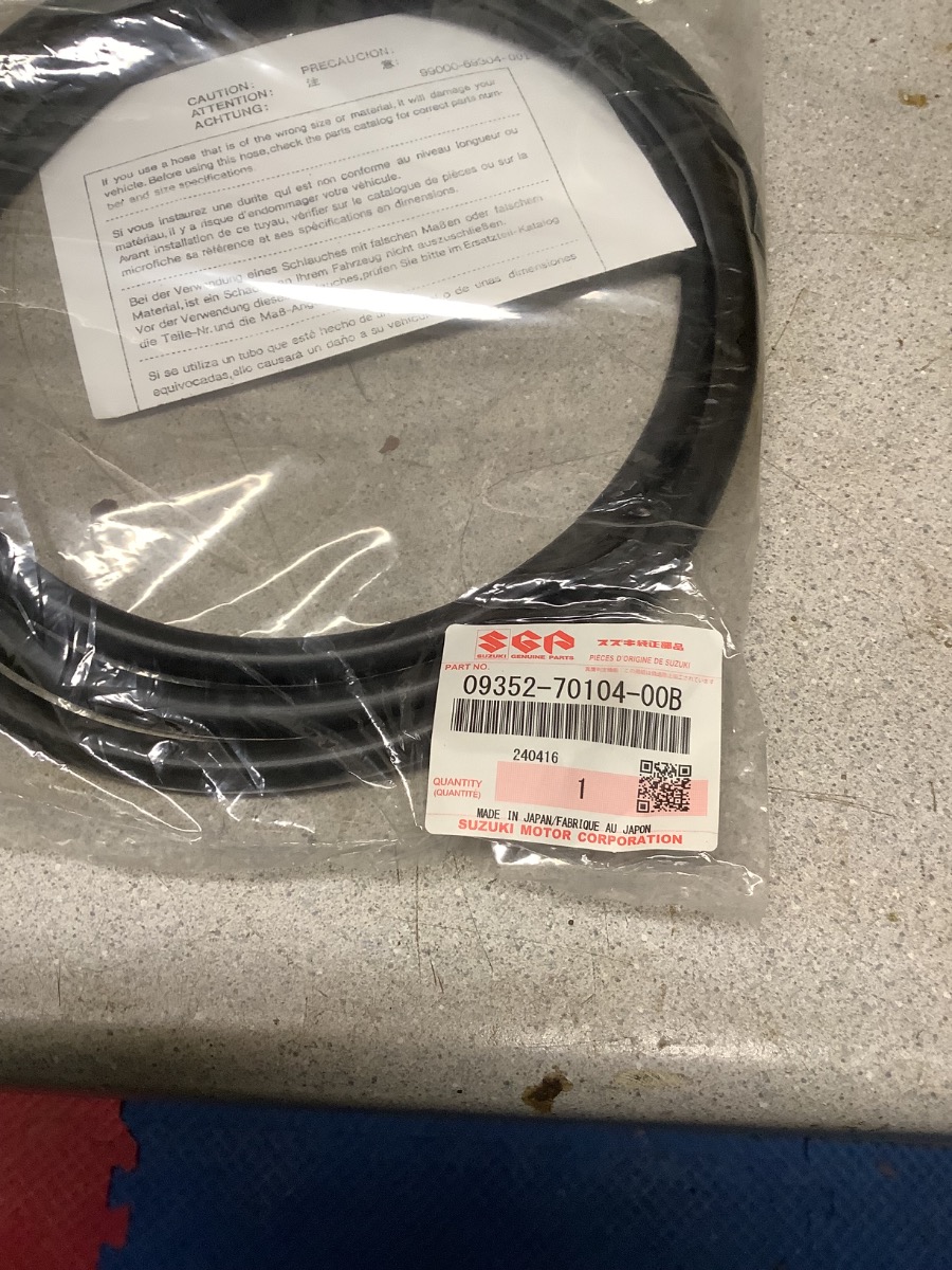

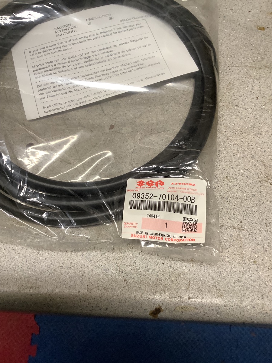

Suzuki PN 09352-70104-00B is 7mm ID and 10.2mm OD, stretchy, not easily kinked, and when you order, they send you about 5' of the stuff. It's the best fuel hose I've used. No clamp needed, unlike thick honk'n car fuel line, that's either too small or too large ID for a good fit.
Last edit: 15 Jun 2026 04:07 by Nessism.

- Posts: 6909
- Thanks: 4340
Re: That Time of Year:What are the part numbers for the high quality OEM fuel lines?
14 Jun 2026 15:45
+2 on the Suzuki hose - I ordered on Ed’s recommendation
