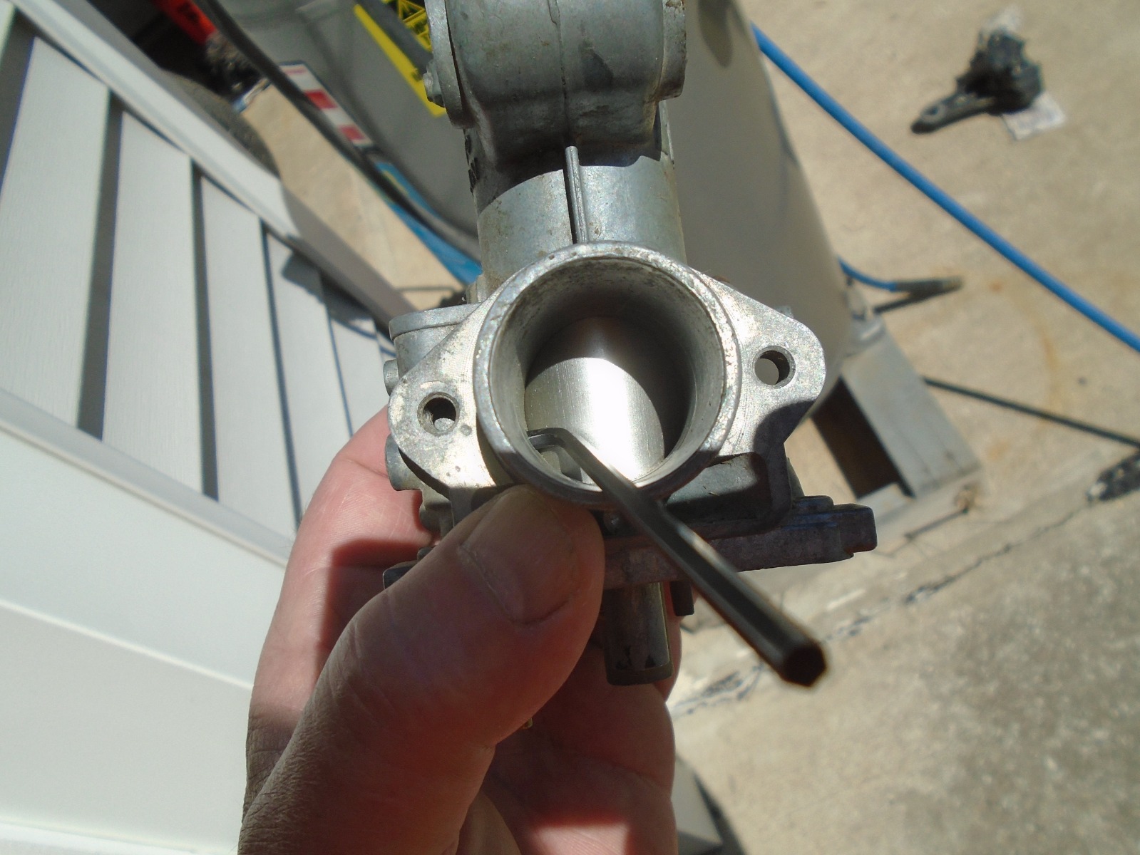

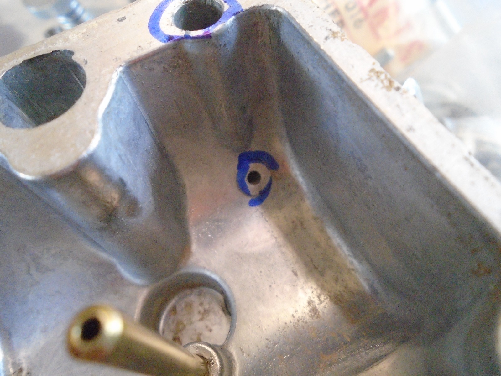

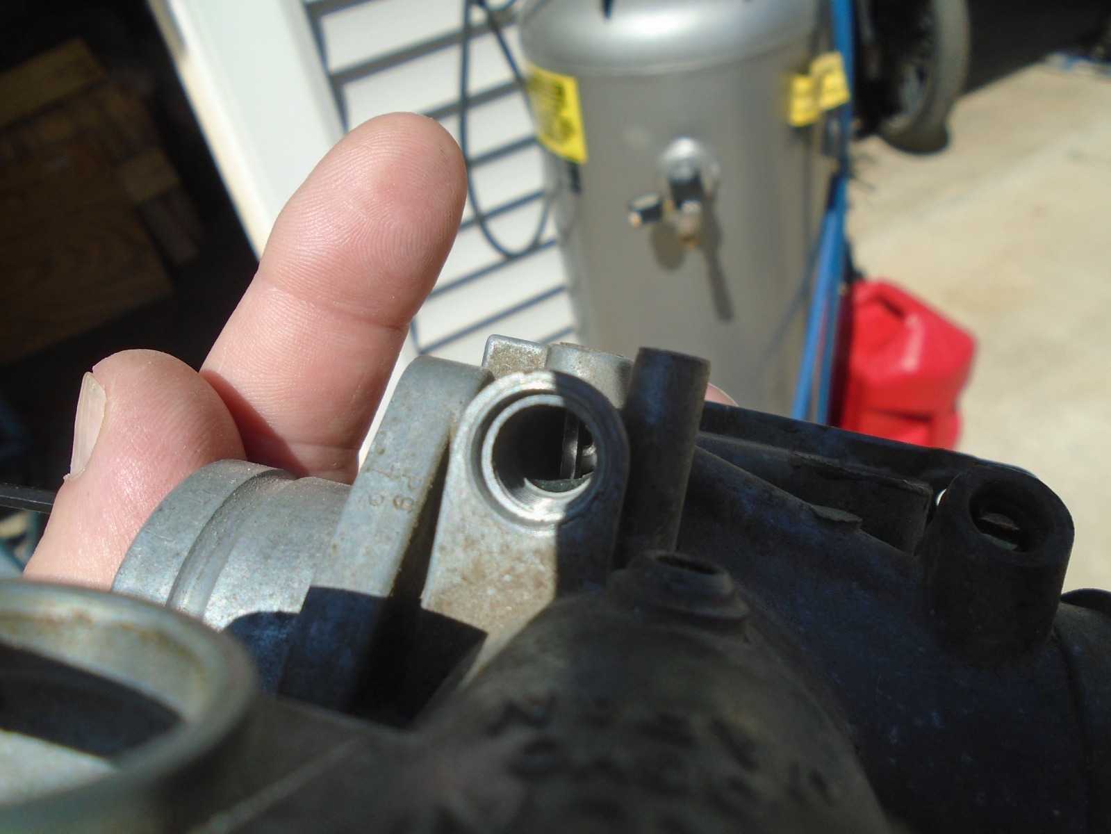

Sounds like float bowl or that extended brass tube jutting out of each carb casting plugged. Bowl starter jet is a cradle just waiting for sediment filling and eventual plugging. Check this first as noted in photos, all the symptoms point to this because it apparently runs fine after. There is a correct way to assemble those lifters, bigger egg shaped down. They made several variations of those in the 900-1000 lineup. Flip the bowl over and you'll not a stamped number right next to the brass overflow nipple, probable "80" in your case. This is the starter jet hole size in MM, so .8mm. Just use a wire/drill bit equivalent to clear. But also look for debris right under the brass jet, clean it out too!

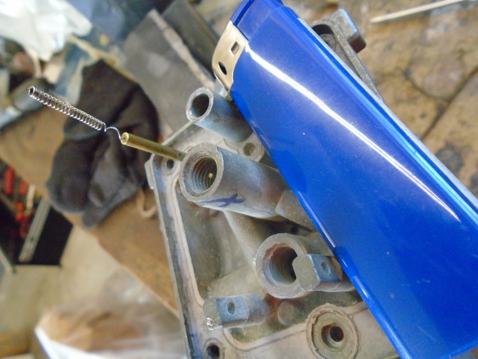

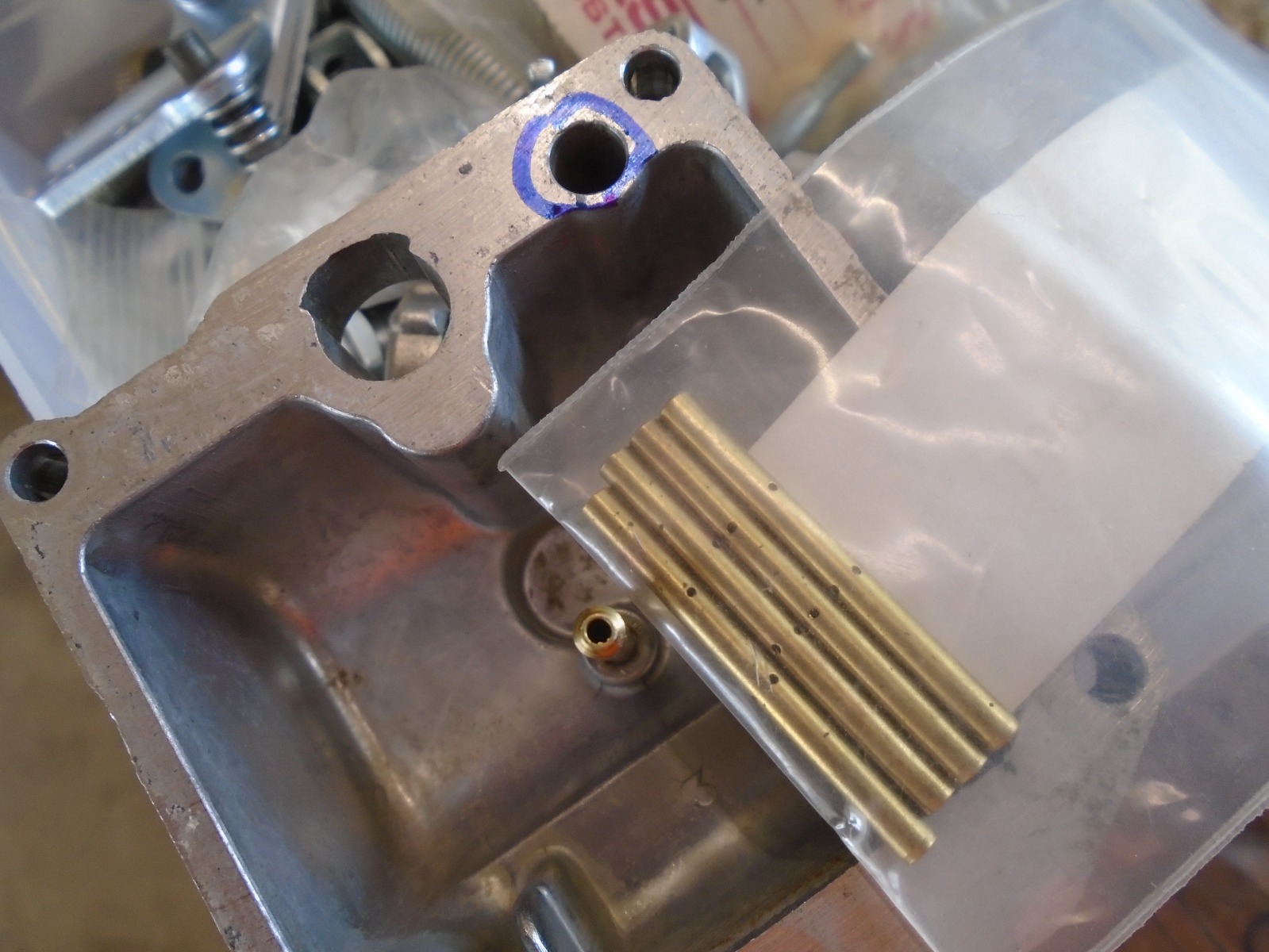

Itll likely ɓe the tiny hole in the bottom end of the brass enricher tube blocked. A bristle from a wire brush is a perfect tool to clean it. (Yes its that small a hole) without them being clear the enricher circuits wont work.

Believe me Sullivan, only trying to help. I do this crap all day, or every other ha. Also as Warren mentioned, wire thru the protruding brass tube. You can even sacrifice an ole lighter spring to use. Too small for the hole but bend it in a way to auger it out. These as Warren has shown, have a flat drilled to spec/swagged over to keep it from falling out slug. Old residual fuel can drain back and rest on that slug, reason i always pull them. Crap can come back down the brass tube if not vacuumed out when starting and repeatedly plug that tiny hole. I'm almost sure you don't have the stuff i have at arms length away to resolve this symptom but You Can Do IT. Also if You felt gritty on the choke plungers, could be a couple things. Plunger and carb bore worn or just filth. But.. Please check those bowl starter jets. Merely shooting crap down those holes doesn't cut it.
