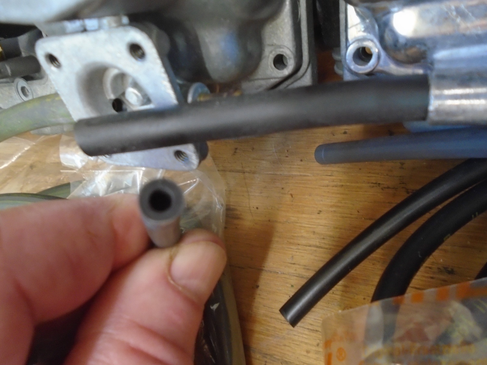

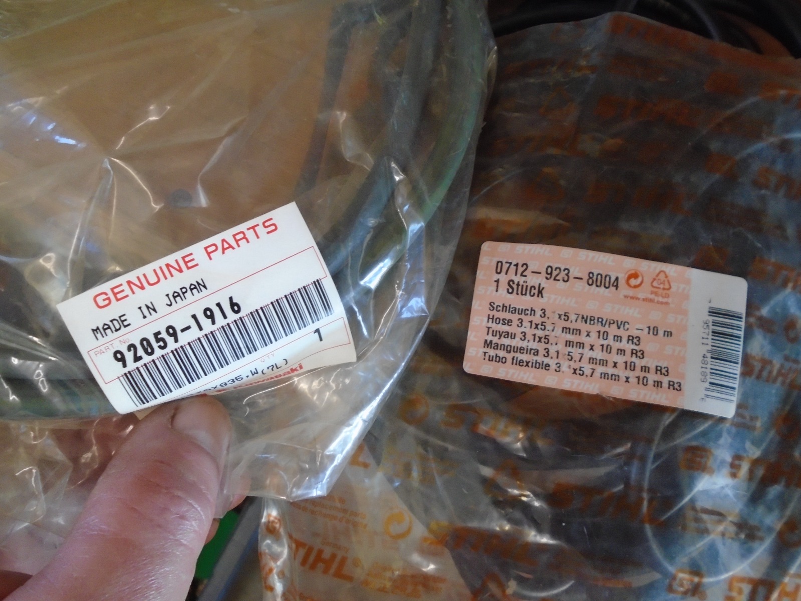

Kawasaki Dealerships started that Years ago H1V, only offering either Motion Pro or that Yellow Tygon. Kawasaki more often then not sold "individual" specific cut pieces, unlike Honda that sold in bulk as you've already found out. I buy in bulk of the Honda because i do a lot of the agricultural equipped engines. It's WAAY better then Motion Pro, motion pro is flimsy in comparison. The Original line used for the bowl Accel transfers was a Two part designed hose meaning it had a layer of some resilient bonded over the inner rubber. Another option, which i use quite often is the Stihl line. It's designed to be immersed in fuel! It's properties allow it to be used as Impulse line (heat) and Fuel line (petrol)
. And it'll last as long as the original! Just options. Shown attached to one barb is what you'll have if using the Honda line.

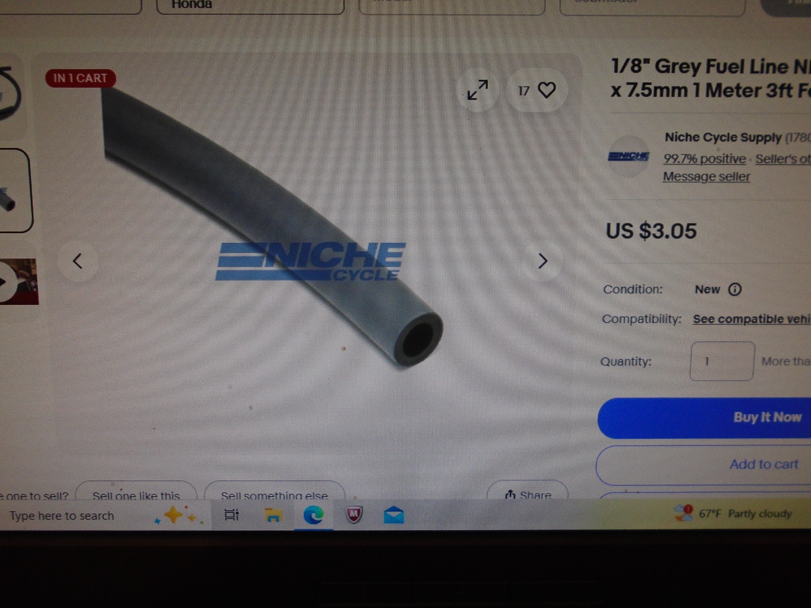

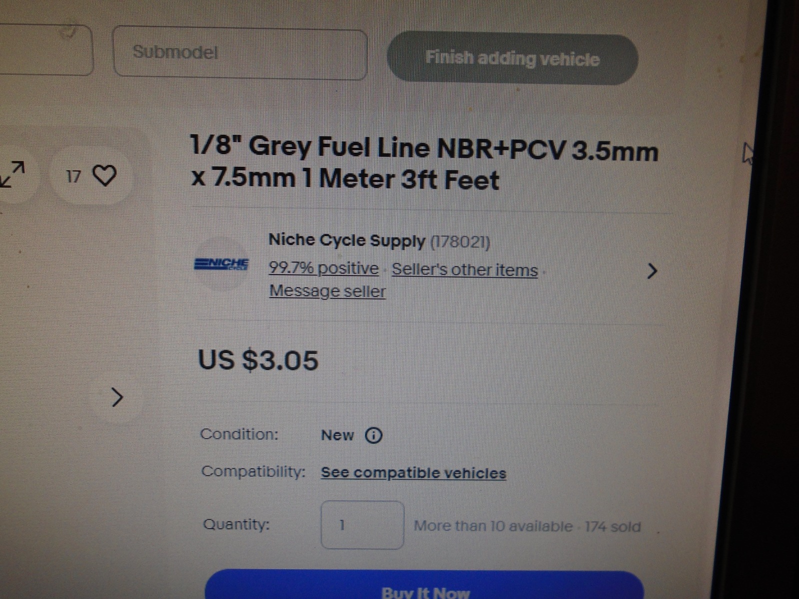

Some additional info if it's helpful H1V. You know the original hose was a grey exterior color. I was trying to remember what that type of hose was called, with the grey exterior wrap? Apparently it's called NBR + PCV, duplicates the original from what i can tell. I just ordered a 3' length of it to try it out off
ebay. Just another option. It was 11.74USD including shipping to Kansas.

The Honda fuel line came up pretty quick in my searches early on, so I didn't bother checking Suzuki or Yamaha.
I just did a basic Stihl search and that part number in the pic came up first. but it's too small and my clamps won't work with it anyway. there's a mower service supply shop near me, so that would've been handy. they very well may have something else, but I already ordered honda. As a side note, I've never seen an accelerator pump fuel line topic and figured somebody had to broach the subject. ha ha.
