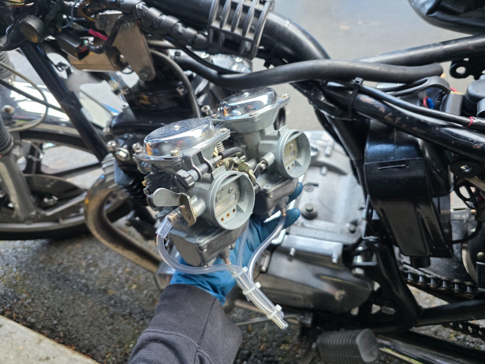

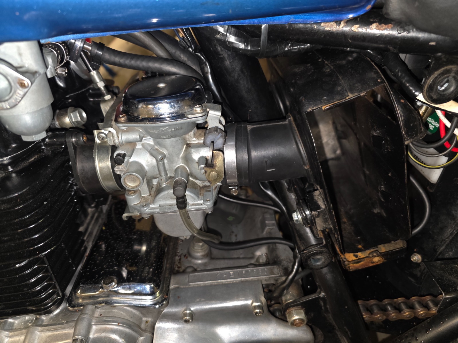

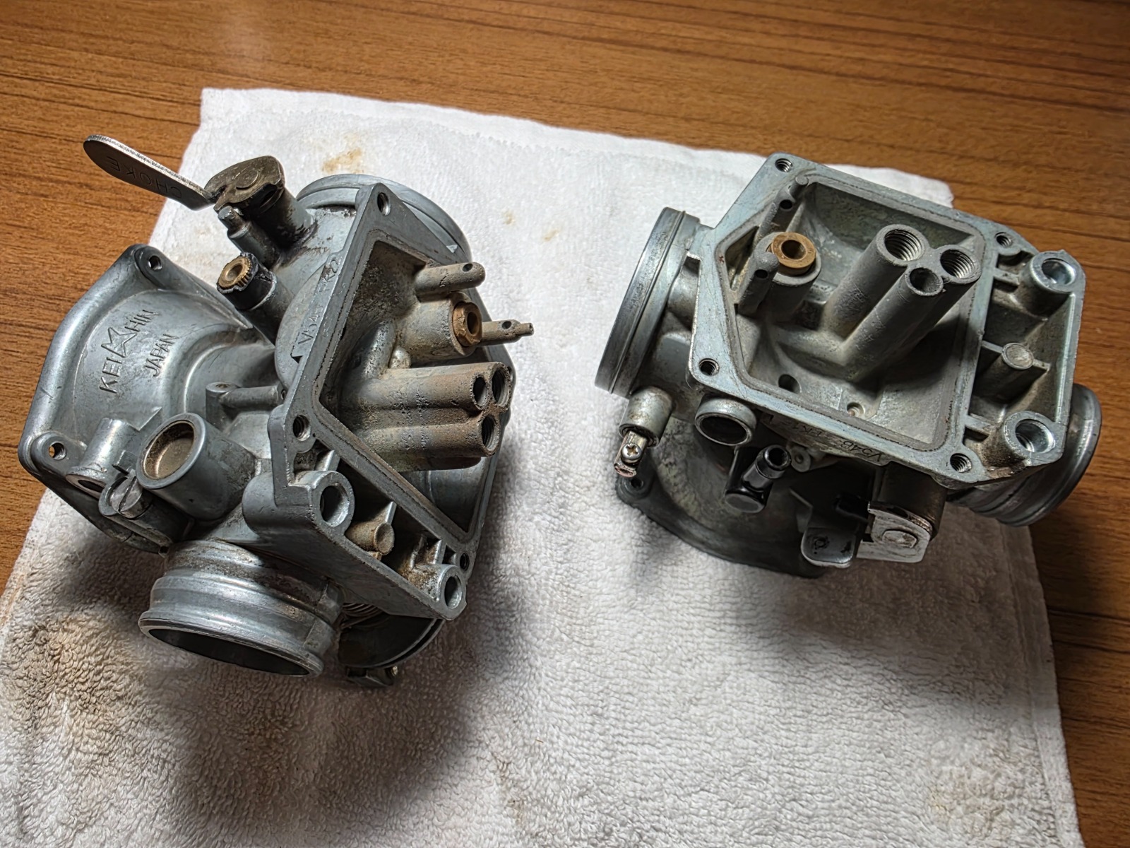

I tried a couple different things with my Mikuni setup but decided to use the factory Keihin CV32 carburetors off my 78 KZ400B parts bike. It was garage kept even after it slid on pavement so they are in nice rebuildable condition. A test fit showed they fit in the 74 frame well and line up with the factory airbox even with the narrower carb spacing of the later engine, so I'm using that too.

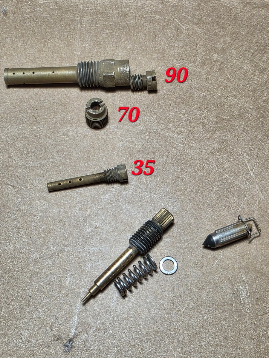

Thanks zed that makes sense. These have two main jets and I ordered a few different sizes of each so I should be good to go. I'll update later with what ends up working best.
I made a note for my own reference might as well share it here too.
stock:main 70 second main 90 pilot 35
ordered:main 68, 70, 75, 78
second main 88, 95, 98
pilot 35
pilot 35

Over the past week I finished cleaning and reassembling the carbs, did a bench sync, and set the float levels. Installed them tonight and it started up and idled perfectly. Runs great but the exhaust smells rich. Right now it has a 78 main jet and 95 second main (needle/pilot) so I'll go down a size or two and see if that helps. Float levels set right in the 1-3mm spec so I hope I don't have to change that. Dial in the jets and do a vacuum sync is all it needs at this point.
