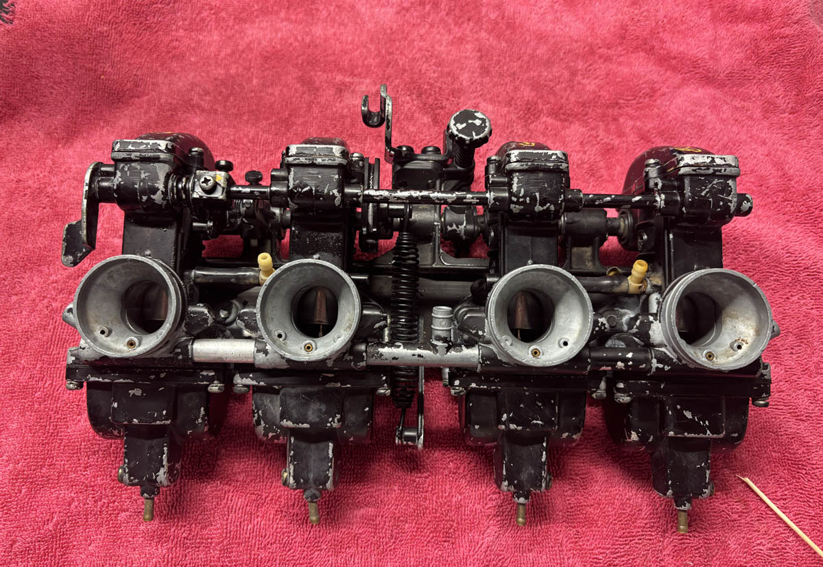

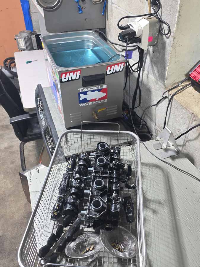

I bought a set of 1981 GPz550 carbs. They have arrived and while they look like they barely survived Dresden they look pretty good and are seemingly clean inside. I pulled all the jets out of them and dropped them off with my guy with a pro-level ultrasonic cleaner. I was gonna pull the top ends off and get the emulsifier tubes out but I lost motivation and gave them to him.
Pilot and main jets were clean. Needle and seat seemed good.

Are you planning to repaint them ?

Def will re-paint them once they return from the industrial bubble cleaner.
Ordering up needle and seat, pilots from KHI.

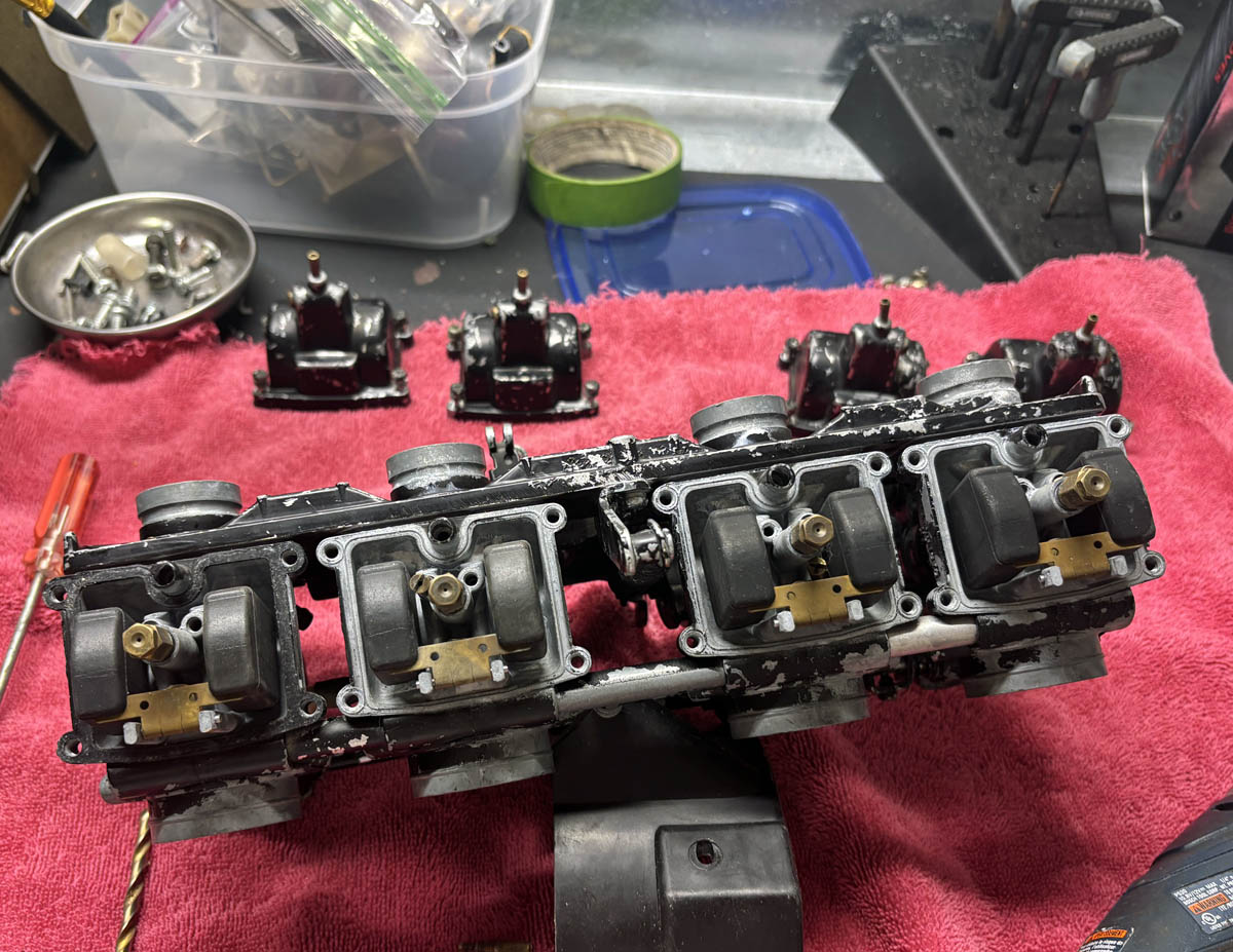

The carburetor bodies need to be separated from each other, and from the mounting bracket, preferably before cleaning, else you will not be able to replace the petrified orings on the fuel transfer tubes. Also, it is much easier to clean the insides of the tubes and the passageways when they are disassembled.

P.S. The throttle shaft assembly can be a bit of a pain to reassemble. I like to take several detail pictures from different angles before disassembly, so I have a good reference for reassembly.

Hope you realize that float needles need to be kept with their parent seat. They wear in together and create a matched set. If replacing the float valves, ignore. Noticed you mentioned replacing them, but the OEM parts are $100 each.
