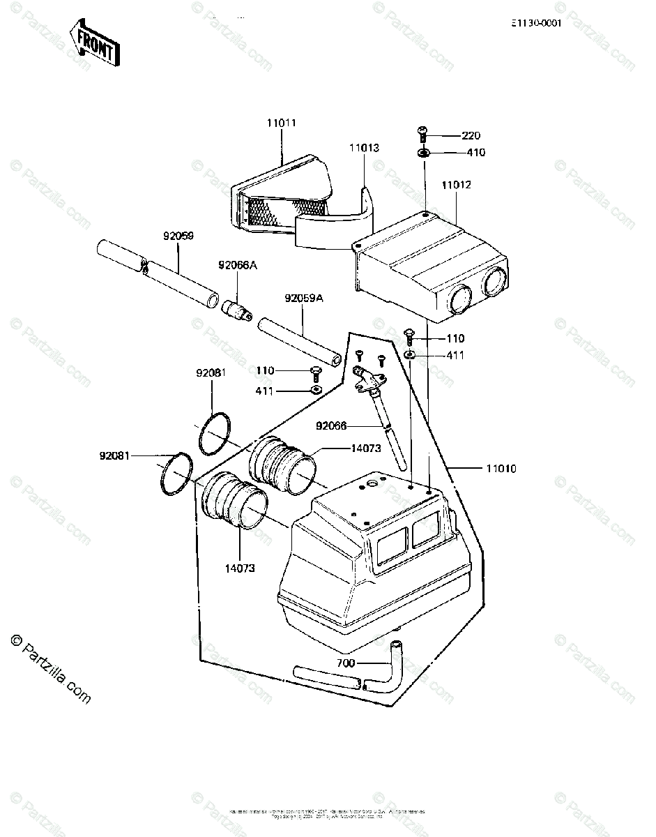

The question: i currently only have the main box with the rubber boots that attach to the carbs. There’s two rectangular holes on the other side that i can see straight through into the carbs. After looking around online it turns out there should be another part that bolts onto that which houses the air filter (again, correct me if I'm wrong, I'm going off what i can see in already sold eBay listings, and the black and white manual). Is it worth finding that box and filter on eBay or elsewhere or just getting aftermarket filters? Im in no way worried about keeping this thing original, it’s a bobber (i had to look up what that ment) project that never got finished so it’s already chopped a bit.

the stock airbox is the best way to go. but are hard to come by. the 440 cap tends to get tossed. on some models because it gets broken. there are mods you can try to get the individual pod filters to function. instead of just connecting them directly to the carbs as is. someone came up with a 3D printed airbox but the plastic didnt hold up. I think that was the problem.
1980 KZ440-A1 Ltd >> www.partzilla.com/catalog/kawasaki/motor...a1/air-cleaner-80-a1
edit: a number of 400/440 models used the same airbox.

From what he said, my understanding was that he has part number 11010 and he needs 11012 since he mentioned that he has an area that has two rectangle openings which is where 11012 would go.
