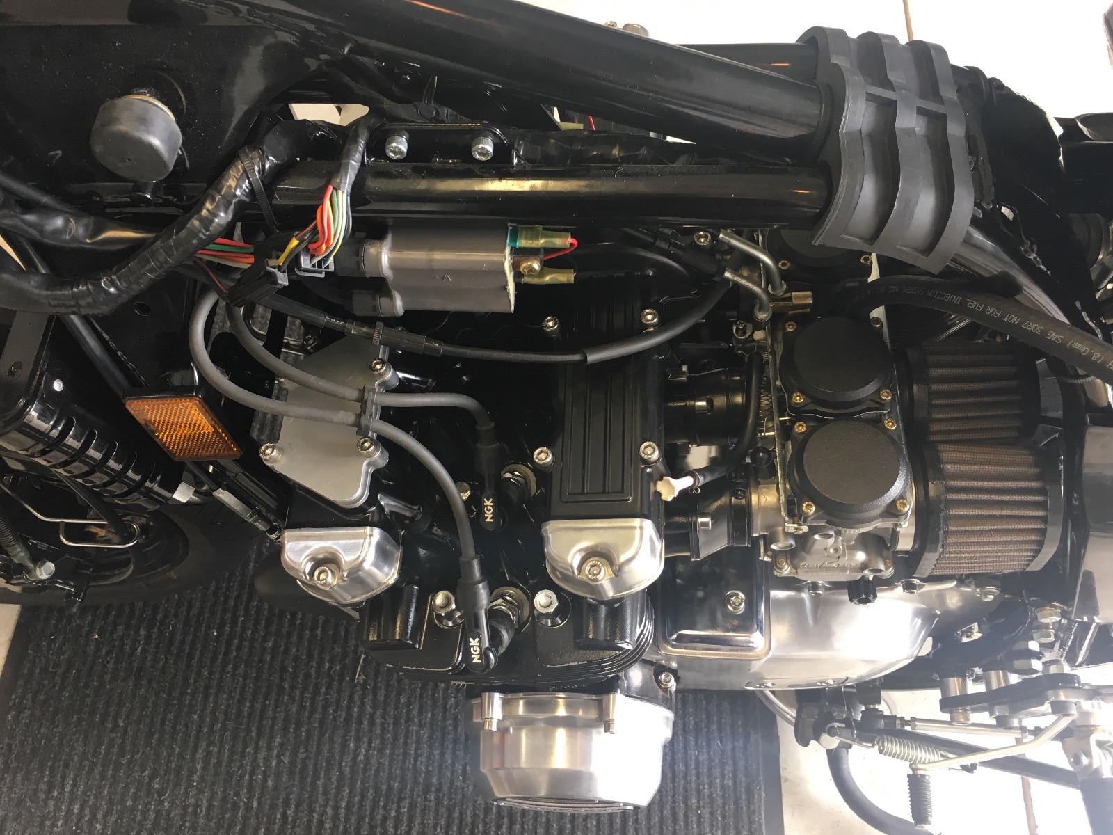

I converted my kz750 to cvk32’s that came from a zx600a/b/c which is the first generation Ninja 600 (otherwise known as the gpz600r everywhere else in the world) and were also used on the Zephyr zr750 bikes. They are exactly the same as the zr-7 cvk32’s except the zr-7’s came with an integrated throttle position sensor. The spacing and inlet and outlet dimensions are all the same for all the cvk carbs of that vintage. They just used different intake boots to account for the difference in cylinder spacing. They only came with 30mm or 32mm bores and different pressed in air jets for the numerous applications they were used for. I chose the zx600 ones simply because they have the exact air jets as the Zephyr and the zr-7 and were a fraction of the price.
To convert, all you will need is the rubber intake boots for a zephyr 750 or the zr-7 , the airbox inlet boots (unless you do pods) a push/pull throttle (or not if you want to live dangerously) and a 750 jet kit from Factory Pro (doesn’t matter what bike they come off of, they all need to be re-jetted as factory tunes were not great to say the least)
My personal setup is zx600 carbs, pod filters, Factory Pro Stage 2 jet kit and Zephyr throttle assembly. I was forced to run pod filters due to the custom nature of my bike and it took a bit to get them tuned correctly. But once I solved the tuning issue, the carbs simply function as flawlessly as if it was fuel injection. No bogs, flat spots, backfires or surging.
I have always wanted a set of fcr flat sides or cr29 specials, just because I love their functionality and design. But I don’t race my bike or spend any of my time in the upper rpm’s, and that’s where those carbs really shine. That and they also cost 4x what I spent on my cvk swap.
The rs34’s are also very clever carbs, but are simply way too big for even the most hopped-up 750.
If you are interested, more carb info can be found in the build thread for my bike. The link is in my bio.

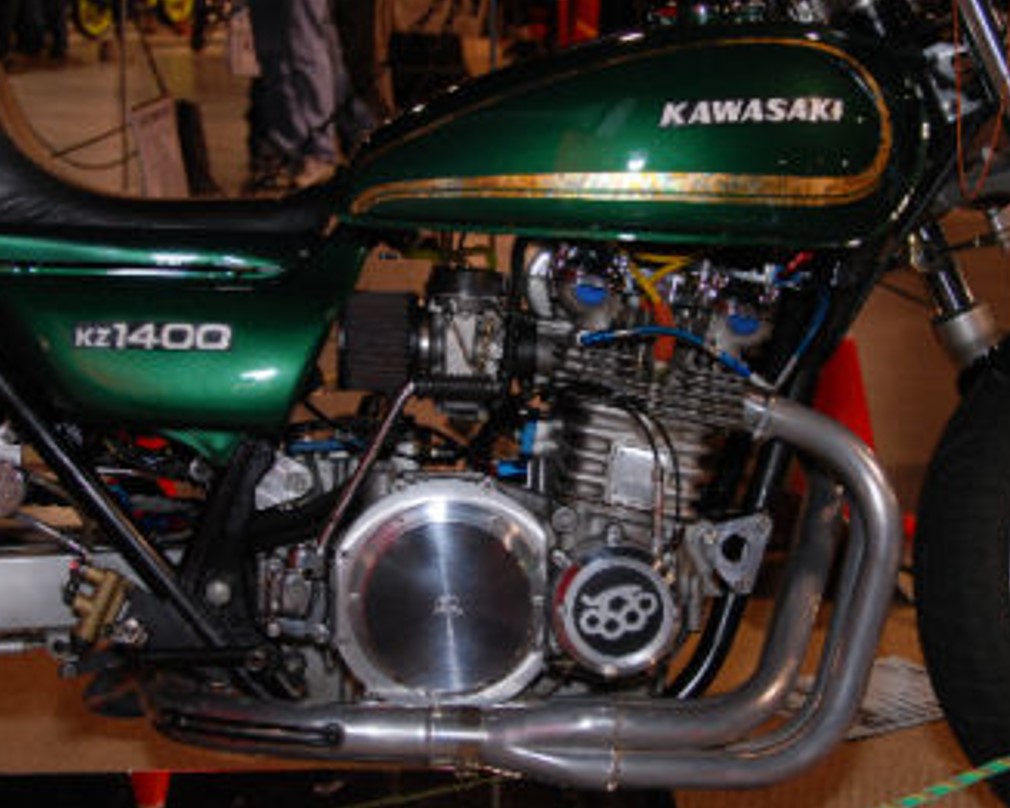

I was also looking for some carbs for my 750 engine swap into my KZ650 frame since the motor did not come with any carbs. I considered OEM style CV34's and some even the RS34's I already had. I ended up using some CVK34's I bought cheap from a 1990 Ninja 750 (not sure if this is the same swap as the CVK32's)
The CVK's are more performance orientated than earlier CV's because they incorporate a hybrid "flat slide" design which gives better fuel pickup and increases CFM potential. All CV's have way better low speed mixture as compared to old round slide carb designs.
From noting these improved design considerations I would not doubt a set of CVK carbs could handle any high performance upgrade you could throw at them (cams/porting/big bore etc)
I have even seen CVK's on a 1428cc KZ based Pro Street bike at a local bike show :
